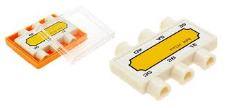

Guest HRB853370 Posted July 3, 2012 Posted July 3, 2012 What about this? Real old school man, but they work.
