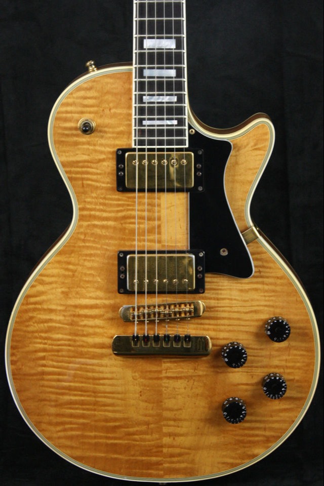

DetroitBlues Posted July 16, 2012 Posted July 16, 2012 Why should they book match when they can do this?

Steiner Posted July 16, 2012 Posted July 16, 2012 Pictures? The top of the solid body 15Xs are shaped. the Flame, curl, figure in wood changes with the shape. The wood I've seen in Kazoo is a rather large ~3" slab that gets resawed on a bandsaw. The bandsaw isn't a very accurate tool so the bookmatched surface has to be sanded smooth. As you sand into the surface, the figure changes creating a dissimilar pattern between the two halves. While they remain close and aesthetically pleasing, the two halves are never perfect mirrored images. Blues - That's a gorgeous guitar! Small blocks on a ebony board and a 1 piece top! Simply perfect.

DetroitBlues Posted July 16, 2012 Posted July 16, 2012 Pictures? The top of the solid body 15Xs are shaped. the Flame, curl, figure in wood changes with the shape. The wood I've seen in Kazoo is a rather large ~3" slab that gets resawed on a bandsaw. The bandsaw isn't a very accurate tool so the bookmatched surface has to be sanded smooth. As you sand into the surface, the figure changes creating a dissimilar pattern between the two halves. While they remain close and aesthetically pleasing, the two halves are never perfect mirrored images. Blues - That's a gorgeous guitar! Small blocks on a ebony board and a 1 piece top! Simply perfect. I'd imagine the owner that that guitar knows just how incredibly special that instrument is and probably appreciates it much more than I did.
Steiner Posted July 16, 2012 Posted July 16, 2012 I'd imagine the owner that that guitar knows just how incredibly special that instrument is and probably appreciates it much more than I did. I bet he plays it most every day...
DetroitBlues Posted July 16, 2012 Posted July 16, 2012 I bet he plays it most every day... I sure hope he does. I think its the best rehabilitation program there is...
fretless Posted July 16, 2012 Posted July 16, 2012 Why should they book match when they can do this? oh my :love
DetroitBlues Posted July 16, 2012 Posted July 16, 2012 and just think... that goodness was covered up with a clownburst...
