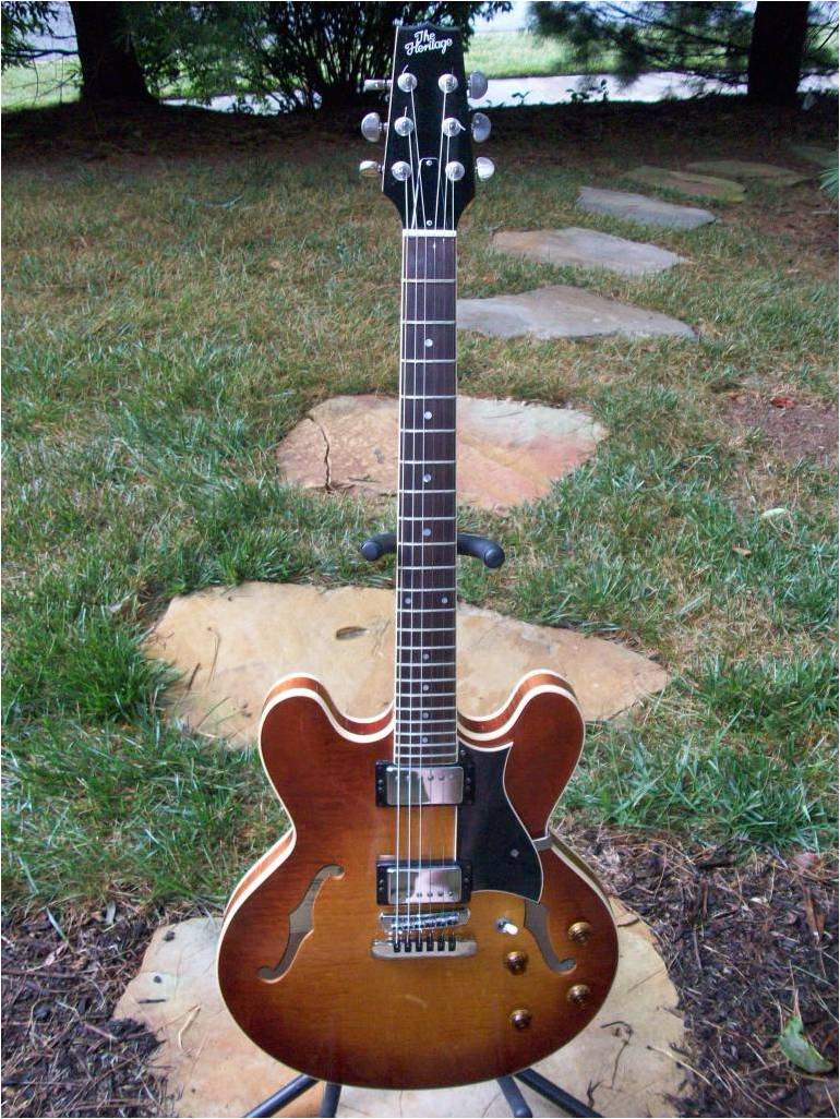

Balladeer Posted July 26, 2012 Author Posted July 26, 2012 GuitArtMan: I could not dictate the neck carve on this as it is a used guitar. Here's a pic of my H535.
