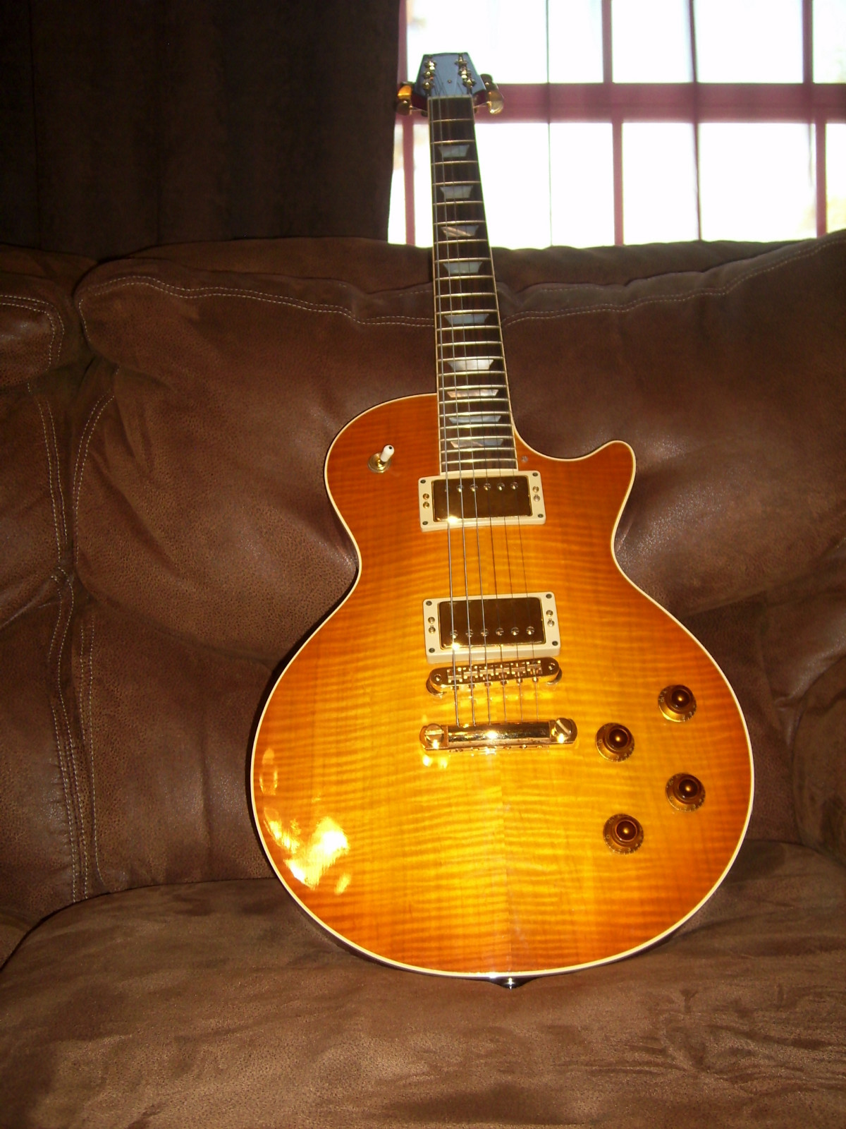

Tallershadows Posted August 11, 2012 Posted August 11, 2012 Hey everyone,I just scored a H150 Ultra. This is my first experience witht the HRW pups. I think the neck pup is great. Clean and overdriven sounds from this pup are nothing short of awesome. However, I felt like the bridge pup is mismatched to the neck. It sounds somewhat shrill and maybe thin to my ears. I did verify that they are both HRWs by removing the pups from the guitar. Beginning to have thoughts of replacing the bridge pup only, but will still play with the amp settings. Does anyone else have a similar experience?

Tallershadows Posted August 24, 2012 Author Posted August 24, 2012 Well, after a few weeks of advice and experimentation, I've come to the conclusion that I am not going to be friends with the bridge pickup. I decided to replace it with another pup. It came down to WCR Godwood, Sheptone AB, and Manlius Fat Diane. I ended up choosing the Manlius because based on the sound clips I could find, they seemed to compliment the HRW neck the best. They have an alnico 4 magnet and are wound to 8.7k. Also, they were only $100 with the gold cover. I installed them yesterday, and I am very pleased. This is how I thought the bridge should sound. The Manlius has the similar degree of warmth and output. The tone is also very similar and the pups are very well balanced. I will keep the HRW bridge in case I need to sell the guitar and to keep it intact. Thanks to everyone for their advice.
