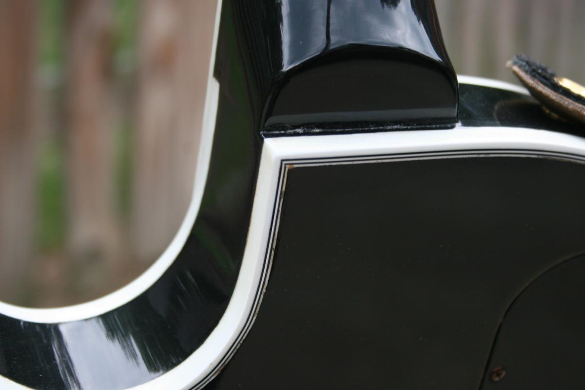

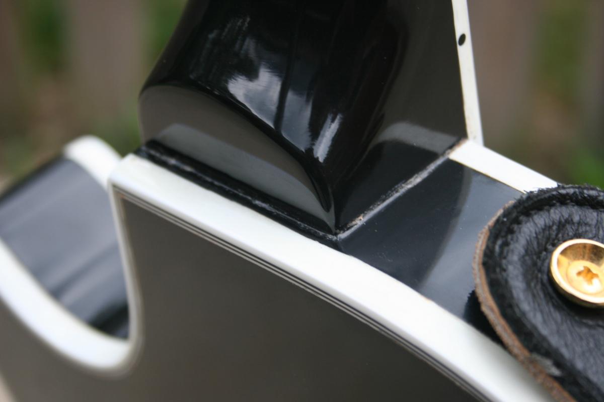

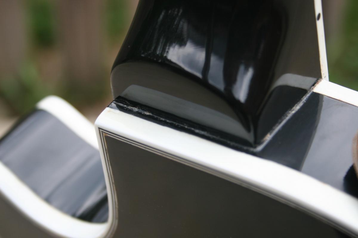

HANGAR18 Posted August 21, 2012 Posted August 21, 2012 Is flaking paint on two sides of the neck joint of a solid body guitar a problem? (See neck joint photos of my H157 in the photos attached. I could only get one side of the neck joint in focus at a time.) Here is why I ask... I was talking to this guy who told me that a crack in the finish like this would allow moisture in and blah, blah blah eventually the neck would fall of the body or something. So, is this a big deal or should I take some sort of steps to protect the guitar from the aforementioned apocalyptic doom the guy predicted?

HANGAR18 Posted August 22, 2012 Author Posted August 22, 2012 see, that area is VERY hard to buff out, and they may do some scraping in there as well. Also due to the different pieces of wood, often you will get a crack there as the wood expands and contracts. How old is the guitar? The guitar is a 2004. I ran my fingernail across the joint (figuring that finish should be stronger than whatever my fingernail might do to it) and I did get some of the finish crumbling off. The photos were taken after I ran my fingernail across the joint.

tbonesullivan Posted August 23, 2012 Posted August 23, 2012 The guitar is a 2004. I ran my fingernail across the joint (figuring that finish should be stronger than whatever my fingernail might do to it) and I did get some of the finish crumbling off. The photos were taken after I ran my fingernail across the joint. 8 years... that is plenty of time for the finish to outgas a lot and become more brittle. The nitro also can shrink a bit, and just due to the different rates of expansion of two pieces of wood, that area gets a lot of stress.
