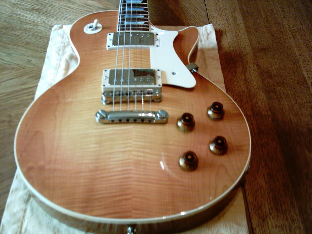

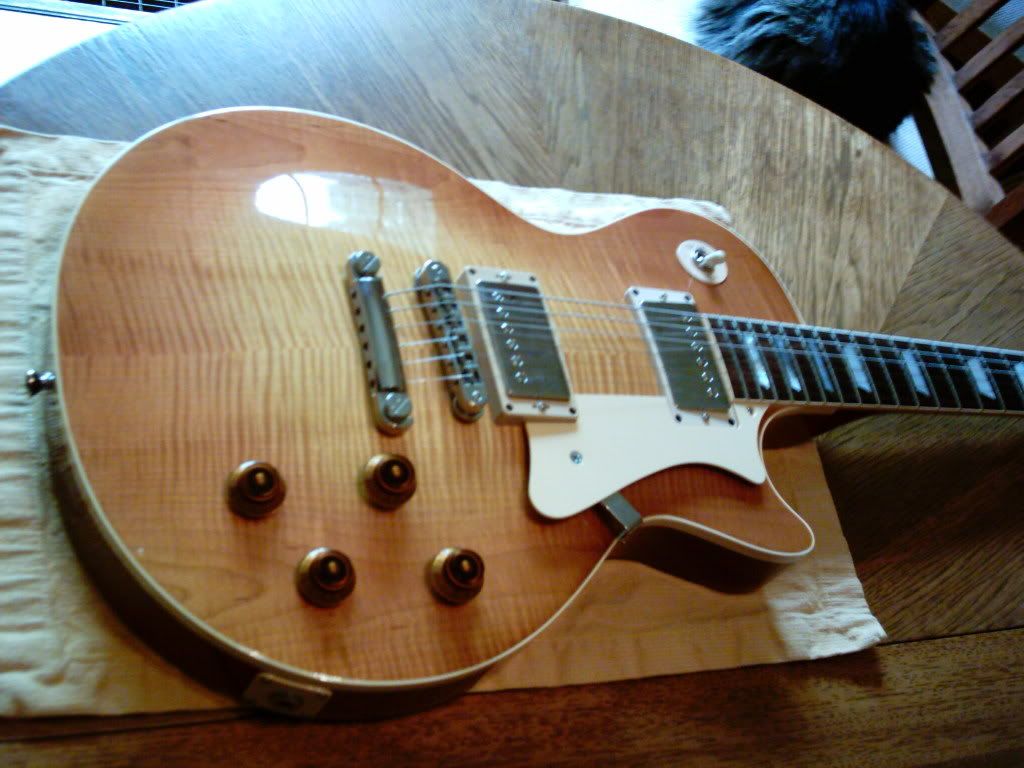

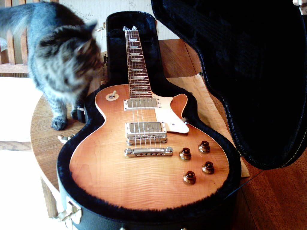

tyleresco Posted September 6, 2012 Author Posted September 6, 2012 Many thanks to golferwave, i didn't have a camera to take pics and he did publish them for me. I wrote to him and he told me about it, i think that now it's more evident that i'm a heritage newbie because it's the first guitar that causes me trouble on setting up. And yes, i'm a big fan of fender guitars, teles and strats are my favourites but i decided to give a try to a heritage and now i face the consecuences. Funny! My first impression was terrific, the body makes a resonance and complexity difficult to reach by other brands, i think it is like my richie kotzen strat but in a heritage level; i liked that but i still can't make it mine, you know what i mean. I think i'll take it to my luthier, he is a gibson specialist and i'm sure he will give me what i want from this beauty. Thanks to all.

TalismanRich Posted September 6, 2012 Posted September 6, 2012 Tyler, The shorter scale should definitely bend more easily with the same string gauge and tuning. You have less tension on the string to reach pitch. As HFB said, raise the tailpiece or top wrap. It could be binding at the bridge which will make it feel stiffer. It looks like the tailpiece is pretty low, which can give a sharp break angle off the bridge. That can cause the string to break more easily. I do full pitch plus bends on my H157 all the time without problems using D'addario 110s, or Pure Blues. Did the string break at the bridge, the tailpiece or somewhere in the middle? BTW, if you are a geek and like to do math. From: http://en.wikipedia.org/wiki/Vibrating_string where T is the tension, μ is the linear density, and L is the length of the vibrating part of the string. Therefore: the shorter the string, the higher the frequency of the fundamental the higher the tension, the higher the frequency of the fundamental the lighter the string, the higher the frequency of the fundamental The linear density is effectively determined by the string gauge.
