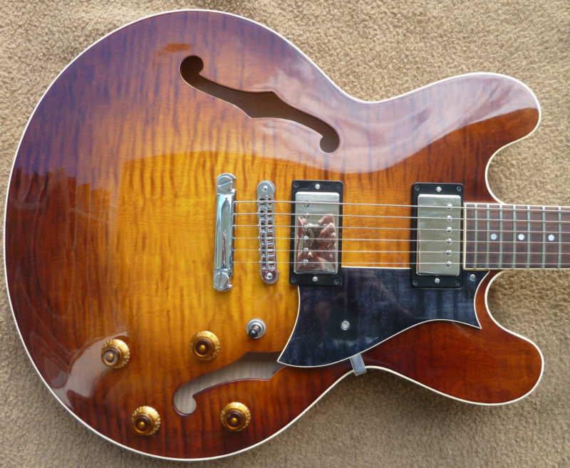

panosy Posted September 18, 2012 Posted September 18, 2012 Hello everybody, so I just got my almost new 535, second hand and only about two months old. Great finish, looks beautiful, came with seth lovers, chunky neck (quite a lot!), new model 2012.. Out of the case it had some 9s gauge string (crazy), anyway I put my normal 12s, quickly set it up (not properly obviously) and took it to a rehearsal. Hm, so it plays like butter, a bit too much as I play mostly jazz and funk and the 12s in my previous guitar, a Peerless Sunset (crazy value for money) were hard, now I am thinking 13s for the Heritage. Will it take them with no trouble? Also, the sound seemed rather solid-body-like compared to my Peerless (which is a semi-size but full hollow, no center block) which I expected but not to that extent. The acoustic sound does not compare at all, but then again it's a different type of thing I guess. I really like the woody tone and I hoped that the center block wouldn't take that away so much. Oh, yes, it's my first 335-type guitar with center block. Maybe it's also a pickup height thing, the sound felt kind of weak (and I have read great things about the Seths) but if I put them higher the plectrum hits the pickup rather often The bridge one was thin and trebly and the neck was pretty good but still not really.. Last thing, the pots, though very smooth in feel, seemed to have a rather sudden drop (both volumes and tones at about 7) which was kind of disappointing. Is that a normal thing? Could it be the pickup height again? Caps? Sooo, re-reading my post I realize I am rather disappointed (or hoping I am doing something wrong), I just wanted to know if you have any advice on setup differences or something that I should check to improve things. I was really waiting for this guitar to arrive and maybe I was expecting (too) much, or maybe a proper setup will bring it back to life.. Or maybe I am not a 335/535 kind of guy? Here's a photo of it, I really wish it can work out for me, it's a beautiful guitar.. Any help is more than appreciated.. ..
big bob Posted September 18, 2012 Posted September 18, 2012 As for string gauge, play what you like. I would not put 13's on a 535 but I don't think the pressure will hurt it. I would not go any heavier. Myself I have 9's on all my solid ans semis, 10's on my 575. As for your expectations a semi is never going to sound like a hollow body. Especially a super thin one like a 535. But they will also give you sounds not available on a solid body. The first thing I would try is adjusting your amp and effects, your semi is going to react really differently than what you had, maybe you just need to tweak your rig till you find the sound. Sometimes we get a certain sound/ tone in our head and if that's not the first one out of a set up we get disappointed. Only to realize later what they can do really is cool, just in a different way than we pconcieved.
Kuz Posted September 18, 2012 Posted September 18, 2012 You need to have the guitar changed to "50s wiring" and that will cure your volume/tone drop off at 7. The modern wiring will cause this. Many jazziers like the modern wiring because the highs are cut rather quickly with only a slight turn of the volume knob. I also would not put 13s on that guitar (frankly 12s turned to standard pitch is probably really pushing it). Raise the pickups or get pickups with more output. I love the Seth neck pup, but I like you don't care for the thinner shriller bridge pup. Finally, it is not a hollow body and will never have the low end of a hollow body. But putting pickup that were slightly hotter and had more mids did it for me.
DC Ron Posted September 18, 2012 Posted September 18, 2012 Your new guitar is really very different from what you've been playing. If you don't like it I'll take it off your hands. Seriously, that's a beautiful guitar and I'm confident It can be tweaked closer to what you're looking for. That being said 13's just wouldn't be right in my opinion. Think I read on here where the boys from Heritage don't recommend above 12. That being said I have 13s on my Super Eagle, but that's an 18" carved archtop, that requires a bit more oomph to get it go. What you get with a semi is feedback resistance and sustain, while maintaining SOME of the "woody" character. (With the guitar unplugged, cup one hand over an f-hole and strum, then lift the cupped hand.) But it will never be an acoustic archtop, or even a full hollowbody. It will be a superb semi tho...Congrats!
panosy Posted September 18, 2012 Author Posted September 18, 2012 Thank you for the answers.. So, of course I am not expecting it to sound like a hollow jazz box (it's not one!), but the acoustic quality (unplugged and amplified) compared to my smaller in size (all dimensions) and a lot cheaper -but no-center-block- previous guitar is night and day. I spent some time today adjusting things, and the main 3 things seem to be the pickup height/balance (including the pole screws), the intonation and the tone/volume pots. I adjusted the pickups to taste (if there is any specific advice for the Seths would be nice) and this improved things quite a bit. The intonation was hard as with the 12s I had to reverse the saddles for a little extra space and it's still all the way down for most strings and still not exactly there but acceptable. Now the pots are a mystery, from 10-7 it's pretty smooth and then there is a drop that makes them practically useless. This is very important as I play a lot with that to get various tones. Kuz you mentioned something about 50s wiring, I looked it up and it seemes to be the case. This doesn't include changes in the parts, just in the wiring, correct? Also I guess I will have to have a tech do it, messing around with the guts of a 335 probably is not such an easy task, this is what I wanted to avoid.. uff, it's getting closer I think, thanks again for the advice guys..
panosy Posted September 18, 2012 Author Posted September 18, 2012 oh another thing, the seth at the bridge is rather shrill and trebly but the neck is good indeed, if I take it to a tech I am thinking of replacing that with something else (a '59 or something else), would the work nicely as a neck pup for another guitar or is it different in terms of resistance and specs (I suspect the latter)?
