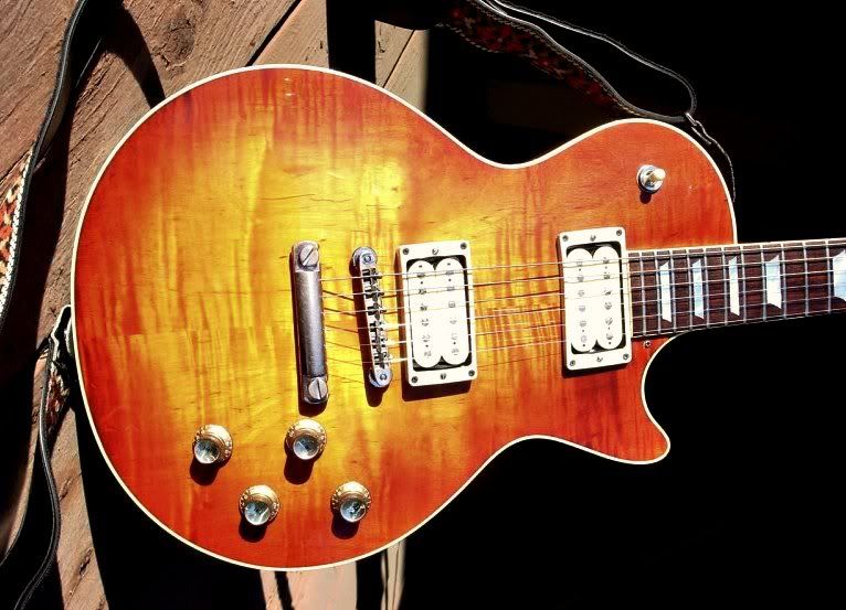

NewGuy Posted October 1, 2012 Posted October 1, 2012 Pots are now 300K and 100s (Vol & Tone) , what differences in the tone s/b expected??Made this mod?" AM too lazy to search...sorry..I know.. if it aint broke...& it sounds good now.Just trying to get the most bang for the buck.Or not. Thoughts appreciated. Thanks!

NewGuy Posted October 1, 2012 Author Posted October 1, 2012 100k on the tone?!? What year is your guitar? I'd say change them bad boys out. Born in 1998 > H150 500Ks it is.. thanks!

tulk1 Posted October 1, 2012 Posted October 1, 2012 Born in 1998 > H150 500Ks it is.. thanks! Love those guitars with mineral streaks. Just look .... sorta vintage/classic!

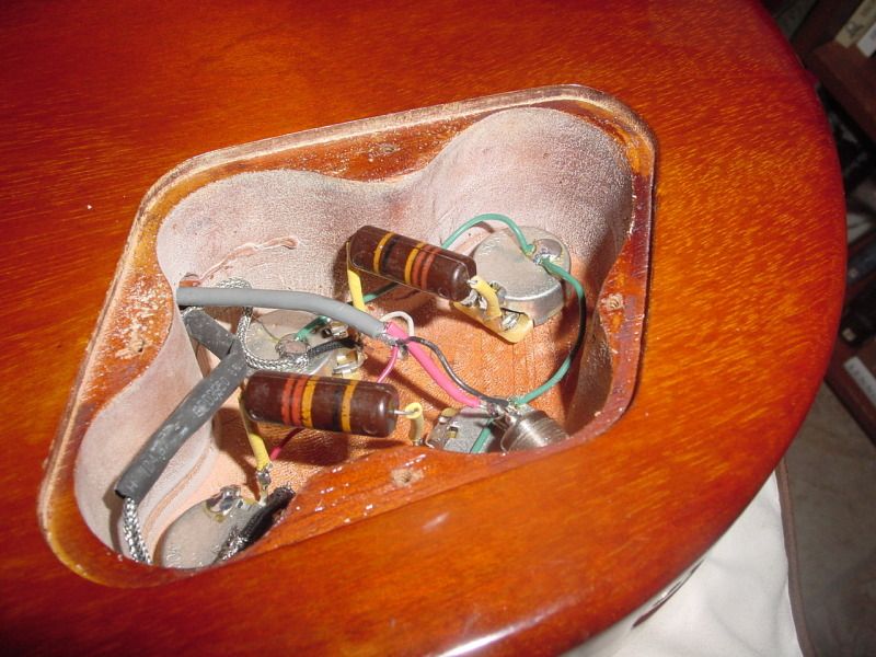

NewGuy Posted October 8, 2012 Author Posted October 8, 2012 Bridge pup sounds honky and nasal, very 3D with a lot of overtones. The neck pup has a great "woman tone", warm and rich, but always clear and articulate at all volume settings, never muddy. Very easy to play pinch harmonics everywhere on the neck. *50's wiring of course, with my prefered pot's values :On bridge: 500k CTS for volume and tone, .022mf Caps.
