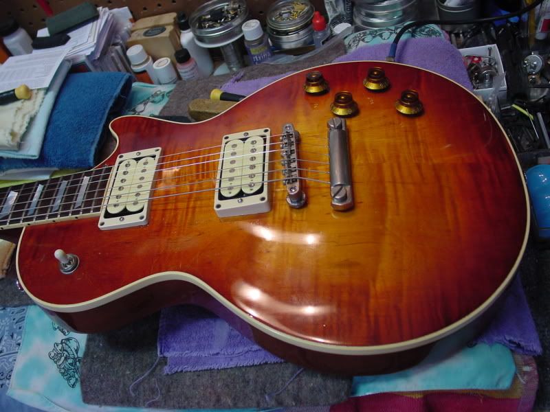

NewGuy Posted October 4, 2012 Posted October 4, 2012 I thought, from the looks of my 1998 H150, that it was shot with Nitro. Come to find out~~ Poly~~wonder why? guessing checking won't be happening anytime soon...
DetroitBlues Posted October 4, 2012 Posted October 4, 2012 Poly is cheaper and quicker to dry when used as a touch up...
NewGuy Posted October 4, 2012 Author Posted October 4, 2012 Poly is cheaper and quicker to dry when used as a touch up... "...a touch up" The entire guitar?
tulk1 Posted October 4, 2012 Posted October 4, 2012 Uh, you sure that's poly? One of the mainstays of Heritage is Nitro Finishes. Guess it could have been a custom finish request, since they are at heart a Custom Shop. But would sure seem strange it's factory poly.
Gitfiddler Posted October 4, 2012 Posted October 4, 2012 I've never heard of Heritage using polyurethane on its guitar finishes.
DetroitBlues Posted October 4, 2012 Posted October 4, 2012 Perhaps it was coated with poly by someone after it left the factory?
FredZepp Posted October 4, 2012 Posted October 4, 2012 Heritage guitars are alway Nitro. I guess there could be something usual out there that's an exception to that, but not a regular H-150. Come to find out~~ Poly~~wonder why? Where did you get this info from? ..
H Posted October 4, 2012 Posted October 4, 2012 Heritage guitars are alway Nitro. I guess there could be something usual out there that's an exception to that... There was a guitar with a strange grey/blue velvet-type finish from the early years. Someone had one a year or two ago and wasn't sure how to refinish it.

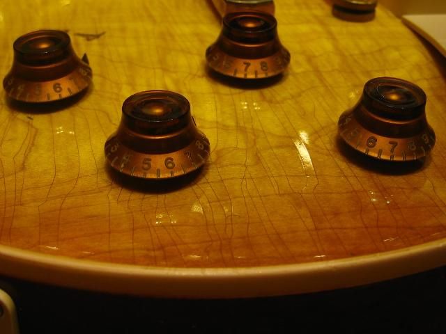

Kuz Posted October 4, 2012 Posted October 4, 2012 1) Heritage ALWAYS use Nitro and would never use Poly at the factory 2) Poly doesn't check like that guitar. This is actually why some guitar companies started using Poly in the first place. 3) You CAN NOT touch up Poly. The whole guitar would have to be re-shot with Poly. You CAN retouch up with Nitro. How do you know your guitar is Poly??? It looks like a classic "Nitro-finish checked" guitar to me. Just trying to help.
Hfan Posted October 4, 2012 Posted October 4, 2012 1) Heritage ALWAYS use Nitro and would never use Poly at the factory 2) Poly doesn't check like that guitar. This is actually why some guitar companies started using Poly in the first place. 3) You CAN NOT touch up Poly. The whole guitar would have to be re-shot with Poly. You CAN retouch up with Nitro. How do you know your guitar is Poly??? It looks like a classic "Nitro-finish checked" guitar to me. Just trying to help. You know after looking at that picture that is what I was thinking. Cool checking for sure. I would never refinish that guitar.
yoslate Posted October 5, 2012 Posted October 5, 2012 It looks like a classic "Nitro-finish checked" guitar to me. Right, John. Classic nitro checking. Poly does not do that....
NewGuy Posted October 5, 2012 Author Posted October 5, 2012 I am not refinishing anything here. Just to clarify..The photo (with checking) is not of my Heritage, that one is a Gibson.I was trying to see if I could get the guitar to check (not w/freeze spray) but by leaving it in a freezer for 12 hours , i then pulled it out on a 100 degree day & shot it with a blow dryer and nothing happened. Did it again the next day, same process nothing happened. Very surprised . This is a 1998 14 year old guitar . It will have just have to age the old fashioned way. It is still a mystery to me since, as you say, they are all Nitro. hmmm? Thanks for the comments ~have a great weekend~ Rock on !
NewGuy Posted October 5, 2012 Author Posted October 5, 2012 Uh, you sure that's poly? One of the mainstays of Heritage is Nitro Finishes. Guess it could have been a custom finish request, since they are at heart a Custom Shop. But would sure seem strange it's factory poly. It sure is strange& I don't get it at all. I know poly ,you can bounce a basketball off of them. Not so here... What looks like checking on the drivers side must be pick scratch? Color me baffled. It is what it is.
NewGuy Posted October 5, 2012 Author Posted October 5, 2012 1) Heritage ALWAYS use Nitro and would never use Poly at the factory 2) Poly doesn't check like that guitar. This is actually why some guitar companies started using Poly in the first place. 3) You CAN NOT touch up Poly. The whole guitar would have to be re-shot with Poly. You CAN retouch up with Nitro. Agreed How do you know your guitar is Poly??? It looks like a classic "Nitro-finish checked" guitar to me. I dont think it is. But it does not check grrrrr & I will not razor blade it as per Tom Murphy lol Agreed, it looks as Nitro as any old Gibson I have ever owned. Just trying to help. One more thing ,since it seems the consensus here is they are all nitro.. Can anyone please post any photos examples of your Heritages guitars that have checked? Thanks in advance...
