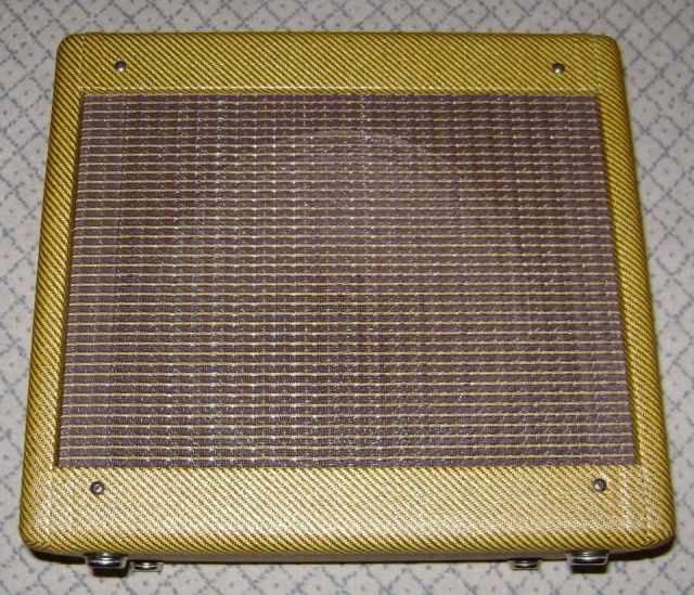

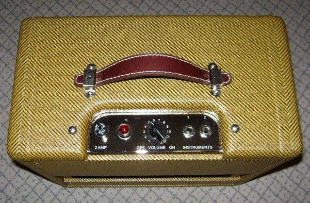

the latest fantastic option is a 5F1 Champ build. This was built by a friend who is very much like our own KBP810, a skilled and knowledgeable bloke who does this sort of thing extensively for others, every now and again for himself, and then sells that item off, and builds something else.
this champ is true to '57 spec, in a beautiful tweed cab, with leather handle etc etc. only exception is it's got a 10" weber rather than an 8" Jensen. I'm thinking about it because I feel that it affords me exposure to one of the "classic" benchmark tones in electric guitar history, I know this guys workmanship, and the price is reasonable. But still, It's coin. I mean, there's that 140 lurking around here.....etc etc...

Don't let a 10" Weber speaker push you away. That's an upgrade to the Jensen IMHO. It sounds like a good deal. Tell me more tonight.

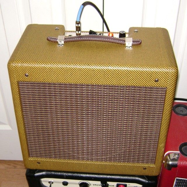

I need to buy some screws to mount the chassis to the cabinet. I plan to do that tonight on my way out for the evening. I should get it set up tomorrow.

Sounds like a really nice amp - I'd go for it if was looking to add a tweed. All the more so w/a 10" over the 8" speaker.

That is a cool looking amp. My vote is to just have it in a head cabinet.
It has a 1/4" speaker output in the chassis, so driving a cab is doable, although access is a bit of a challenge with the panels installed
a new head cab isn't hard to find. You won't need that 1x8 cab...

it's a 1 x 10, but your point is noted. :icon_salut:

This is a pretty decent build, decent parts and as is can be a great grab-n-go combo or drive a bigger cab. Winner if you like to play through it.

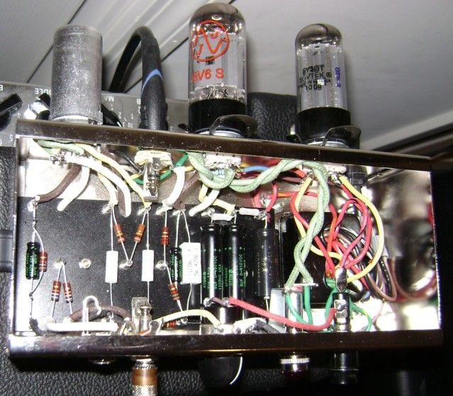

Not a lot of changes, larger transformers, a slight mod to the tube socket, and a larger bias resistor.
Those are the same transformers that my 5f1 uses. They are made in Chicago and they have a good reputation.

What's the charge from those guys? Never heard of them before.
you mean the PT's? I can't tell you, as they are part of my finished build. Boothill's kits don't include PT's, so maybe PK knows what these (pictured) PT's run?
or...you can call and ask.

This amp getting done up right now is the gateway drug of all time for finding out what's on the backside of the glory holes guitar players have been sticking their plugs into for years and years. ANYTHING can be easily changed out that matters, even transformers. I ripped the guts out of my Silverface Champ around four-five years ago and replaced just about everything, including tube sockets and trannies. The parts that were put in were unusual for guitar amps, and the result is unusual in a good way.

Look how easy it is to swap out a tube, and there are only 3 of them, cheap date for a vintage tube roll in the clean and dirt.

In this design, a soldering iron tip goes just about anywhere necessary to change out a part to something else to try out, like a cap, resistor, substitution, circuit mod(s), swapping out different output transformers, piggybacking a few extra filter caps for beef's sake?
