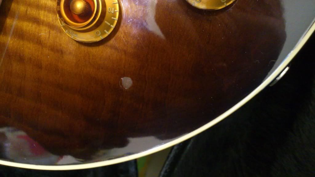

Kap Posted October 16, 2012 Posted October 16, 2012 Help. I allowed one of my students to play on my H-150 while I was busy with others. A week later I opened the case to spend some time with it and found this!!!! http://i1066.photobucket.com/albums/u404/LionsCollege/DSC_0783.jpg http://i1066.photobucket.com/albums/u404/LionsCollege/DSC_0784.jpg It looks as if a near perfect circle of the coating has come off taking the colour with it.What does one do now? (apart from never letting students near favoured instruments ever again!)

H Posted October 16, 2012 Posted October 16, 2012 Take the guitar and the flake of nitro to a luthier. Nitro can be repaired and you may get a very good repair if the flake fits the hole exactly. Don't be tempted to glue it!
TalismanRich Posted October 16, 2012 Posted October 16, 2012 Did the flake stick to something on the key or is it just laying on there?
Kap Posted October 16, 2012 Author Posted October 16, 2012 Found the flake (luckily in the case) I just put it there so it can be photographed. I had briefly thought about PVA glue but better sense and blood pressure pill took effect. It looks like he may have pulled the guitar lead off but because the connection is a bit tight, he may have instinctively JERKED back, the size and shape is almost perfect to the diameter of the input lead. (I'm opening a bottle of scotch tonight....... much more pleasant than the BP pills). By the way the said student was a regular to my office as he loves guitars, and I had thought it strange I had not seen him for over a week in that interim period between him playing it and me discovering it. Has not had the courage to visit and avoids me on campus.

FredZepp Posted October 16, 2012 Posted October 16, 2012 That's odd. But yes... take that to someone used to working with nitro and you'll be amazed with the results... It sounds like your student is embarrassed and scared to talk to you about it. Show him the repair when it's fixed and start over...

tbonesullivan Posted October 17, 2012 Posted October 17, 2012 any luck finding a tech to do it? As you still have the chip, it may be as simple as putting some solvent or dilute nitro on, putting the chip in and squishing it down, and then covering with some more nitro. Then of course a month or two to dry, and then sand down and buff out. But yeah, if you're gonna loan out a guitar, i'd loan out one that has some battle scars. Kinda lame of the kid not to fess up though.

tbonesullivan Posted October 19, 2012 Posted October 19, 2012 You didn't try to glue it back? I would have, just so it would protect the wood. but in the end, if you play it, it's gonna get chips and dings, and other wear. doesn't matter how much you baby it. the only way to make sure nothing ever happens to it would be to lock it away.

fretless Posted October 19, 2012 Posted October 19, 2012 should be an easy fix for a skilled Luthier , nitro melts into itself .
Kap Posted October 19, 2012 Author Posted October 19, 2012 So I'm led to believe, but need to find a 'skilled luthier' in Hong Kong. I know Tom Lee has stopped carrying the Gibson range and now has a great range of Heritage so might stop in and talk to the tech. there.
