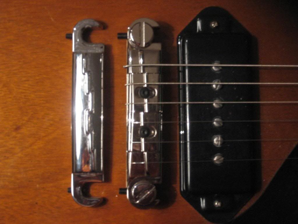

plexirocker 68 Posted November 25, 2012 Posted November 25, 2012 Thought I'd post something that may help other Heritage owners. I have a recent Les Paul Jr. with the compensated stop tail/bridge combo that only intonates o.k. Been driving me nuts so I've done battle the past couple of months to find a clear winner IMO After several popular alternatives glad to report this one is the winner. Not only is the intonation spot on but it just sounds way more alive. Definately brighter than the stock bridge which was "dark" sounding or muddy. This newer bridge sounds much more " alive" with great overtones and a clarity that the old junior bridges have, less moving parts than a pigtail or Badass Wilkinson by Gotoh made in Japan All Parts # TP 3691-001 Nickel plexi

bluesgolfer Posted January 23, 2013 Posted January 23, 2013 Thought I'd post something that may help other Heritage owners. I have a recent Les Paul Jr. with the compensated stop tail/bridge combo that only intonates o.k. Been driving me nuts so I've done battle the past couple of months to find a clear winner IMO After several popular alternatives glad to report this one is the winner. Not only is the intonation spot on but it just sounds way more alive. Definately brighter than the stock bridge which was "dark" sounding or muddy. This newer bridge sounds much more " alive" with great overtones and a clarity that the old junior bridges have, less moving parts than a pigtail or Badass Wilkinson by Gotoh made in Japan All Parts # TP 3691-001 Nickel plexi Which ones did you compare it to?
plexirocker 68 Posted January 24, 2013 Author Posted January 24, 2013 1.Bad Ass bridge, 2.wilkinson lightweight- it has the wilkinson logo stamped on it 3.tone pros 4.pigtail 5.standard Gibson issue bridge plexi
bluesgolfer Posted January 24, 2013 Posted January 24, 2013 1.Bad Ass bridge,2.wilkinson lightweight- it has the wilkinson logo stamped on it 3.tone pros 4.pigtail 5.standard Gibson issue bridge plexi What, if anything did you not like about the Wilkinson lightweight? Or, rather, how did it compare the Wilkinson you chose?
plexirocker 68 Posted January 24, 2013 Author Posted January 24, 2013 The wilkinson lightweight wouldn't "square up" with the string alignment, so I couldn't get it to intonate right because of the break angle on the bridge. It wouldn't work for my guitar because these studs aren't parellel, they are ever so slightly a little off with the low E side farther from the pickup than the high E side The All parts # for this bridge is #TP 3691-001 nickel plexi
bluesgolfer Posted January 24, 2013 Posted January 24, 2013 The wilkinson lightweight wouldn't "square up" with the string alignment, so I couldn't get it to intonate right because of the break angle on the bridge. It wouldn't work for my guitar because these studs aren't parellel, they are ever so slightly a little off with the low E side farther from the pickup than the high E side The All parts # for this bridge is #TP 3691-001 nickel plexi thanks plexi
bluesgolfer Posted January 26, 2013 Posted January 26, 2013 1.Bad Ass bridge,2.wilkinson lightweight- it has the wilkinson logo stamped on it 3.tone pros 4.pigtail 5.standard Gibson issue bridge plexi Plexi: I purchased one and am having it installed. Did you use the studs and/or anchors that came with it, or tone pros, or something else? thanx
plexirocker 68 Posted January 27, 2013 Author Posted January 27, 2013 I got the tone pros locking studs in STEEL, I think they help a lot as it takes out that forward lean and has a very precise string break angle over the bridge plexi
plexirocker 68 Posted January 27, 2013 Author Posted January 27, 2013 The best way to adjust intonation on this bridge is adjust the low E and get it right by moving it either foreward or back, then the high E side using the screws, same as above. Then once those 2 points are set adjust with the allen wrench the A/D section then the G/B section plexi
bluesgolfer Posted February 7, 2013 Posted February 7, 2013 Just got my Korina H-137 back from the Luthier. Put the Wilkinson on with steel tone pros studs and it intonates perfectly. Sounds great. Great tone. My luthier really liked the Wilkinson, said it was high quality. Highly recommend this bridge. Thanks Plexi for the advice.
plexirocker 68 Posted February 7, 2013 Author Posted February 7, 2013 Just got my Korina H-137 back from the Luthier. Put the Wilkinson on with steel tone pros studs and it intonates perfectly. Sounds great. Great tone. My luthier really liked the Wilkinson, said it was high quality. Highly recommend this bridge. Thanks Plexi for the advice. Awesome, glad to be of service plexi
