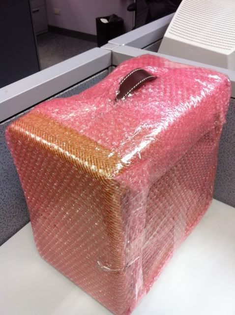

kidsmoke Posted November 30, 2012 Posted November 30, 2012 Well, took a little longer than intended, but I finally got my mitts on a handbuilt quality amp Lots of photos in this thread, inside and out. So I won't add too much to it. http://www.heritageownersclub.com/forums/topic/19724-seek-input-5f1-experience/page__hl__champ to review, A friend of mine is a moderator at BYOC, an EE and long time hobbyist. His clone pedal business grew too big for real life, and he's backed off, no longer selling as a business. He still builds everything that the BYOC sells, as a troubleshooter and "editor" of build sheets and schematics. Long story short, Dude knows his stuff. This was his personal build of the BYOC 5F1 kit, with a Mojotone Tweed cabinet and a custom 10" baffle...the only mod to the kit, in this case, being the 10" Weber Sig 10AS 8 ohm alnico speaker, shoehorned into the cab. this is the third piece of gear I've purchased from him, all built by him. He does excellent work. Showed up at work yesterday. looking like this. Problem is, I'm an El commuter (subway, for all intents and purposes, for those of you not familiar with Chicago Public transit. If you ever watched ER back in the day, you know the "El") So for the commute, we traveled like this I released the leather handle, left it wrapped. So couldn't thoroughly inspect til i got home. I was reservedly optimistic. Reason being these amps are known to favor single coils. I've got a tele, and hope to have P90's in the stable soon, but I love my buckers, and hoped this could become my everyday amp. Early returns are, it will. I am having one issue with it however, and I've contacted my friend. at bedroom level you can hear a rattle. After much tribulation, it appears that low notes cause a vibration in the chassis. If I press up on either the Sovtek 5Y3 rectifier tube or the JJ 6V6 Power tube, the rattle greatly diminishes. If I press both simultaneously, it disappears. These are essentially new tubes. Seller and I agree, that it's not the tubes, but something closely associated with the mounts that is loose. Anyone else have a theory? Gut shot for reference....
