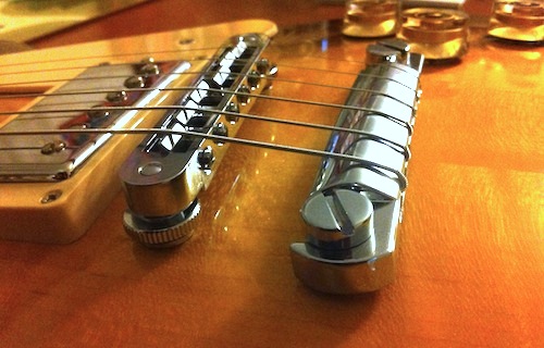

kidsmoke Posted December 4, 2012 Posted December 4, 2012 ... have a steeper than normal neck set. This in turn makes the bridge a bit higher than normal, which makes for a steeper break angle over the strings. I like to crank my tail piece down as tight as possible. This is what led me to do it on my 535. In order to have the proper action, the bridge is skyhigh. Being a wider nashville bridge, this meant that in order for the strings to avoid contacting the bridge behind the saddles en route to the stoptail, that tail had to be super high as well. I had read a couple of articles and books on set-ups, and they stressed that this should be avoided. Top wrapping allowed that. easier to bend? Eh, maybe. But no flexing of the tail, and the tail is now solid to the top. A search on this topic will yield a couple previous threads on the topic. before photo... it's clear that if I were to try to lower the tail, the strings will break over the bridge, and not just the saddle. after...you get the point. I've since changed hardware and eliminated the tilt. So between the fact that the hardware is solid to the top, the strings only break on the saddle, they don't slip from their grooves while bending, which may be a bit easier, and yeah, Allman, Gibbons and Bonamassa all are able to do it without detriment...i'm down with it. If the neck angle didn't demand it, I wouldn't bother.
Kuz Posted December 4, 2012 Posted December 4, 2012 i'm down with it. If the neck angle didn't demand it, I wouldn't bother. Bingo, I check that my strings clear the back of the TOM without hitting the bridge by taking a piece of paper and see if it easily will slide between the bottom of the string and not hit the bridge. If it does hit and the paper won't slide through, I raise the stop tail a quarter of a turn until the paper slides under the strings and doesn't hit the bridge. I have not had to raise my stop tail anywhere near as high as the first photo, so I don't top wrap. Terry McInturff once told me that since the Nashville bridge has metal studs going into the top to of the guitar where the bridge screws into, that it is nearly impossible to collapse a Nashville bridge with too much tension of the strings hitting the back. He said if the strings just barely hit the back of the Nashville bridge you should be OK. I error on caution and try my best so they don;t hit, but if they just do hit the back of the bridge I won't raise the stop tail.

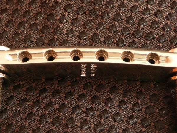

kidsmoke Posted December 11, 2012 Posted December 11, 2012 I want to see what happens to the top of the tail stop first. are you referring to the "damage" done by the top wrapping? this is a Schaller stop tail that was top wrapped with 10's for a while. Keep in mind, it's a simple component to replace if you felt you needed to restore if for a later sale.
Billgelder Posted December 11, 2012 Author Posted December 11, 2012 are you referring to the "damage" done by the top wrapping? this is a Schaller stop tail that was top wrapped with 10's for a while. Keep in mind, it's a simple component to replace if you felt you needed to restore if for a later sale. Thanks Bud Can show a pic of the top of the tail stop?
kidsmoke Posted December 11, 2012 Posted December 11, 2012 Thanks Bud Can show a pic of the top of the tail stop? Nope. Ha. Sorry, I may have an additional photo at home on my laptop, I'll look this evening. sold this set, but as I recall, the string departs quickly from the tail, and there was barely noticable marring for maybe an 1/8" beyond what you see here. Took this when I had it for sale. Full disclosure doncha know. FWIW, I replaced this with an aluminum Faber tone lock tail, and promptly top wrapped that one too, with no qualms whatsoever.
Billgelder Posted December 11, 2012 Author Posted December 11, 2012 Nope. Ha. Sorry, I may have an additional photo at home on my laptop, I'll look this evening. sold this set, but as I recall, the string departs quickly from the tail, and there was barely noticable marring for maybe an 1/8" beyond what you see here. Took this when I had it for sale. Full disclosure doncha know. FWIW, I replaced this with an aluminum Faber tone lock tail, and promptly top wrapped that one too, with no qualms whatsoever. Cool thanks
