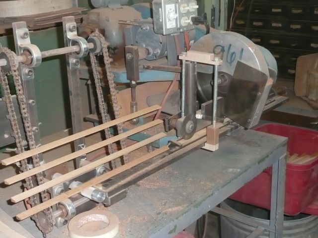

Spectrum13 Posted December 10, 2012 Posted December 10, 2012 At PSPV Jim was showing me how he uses the rim bending steam tool. He said he cuts strips thin enought to bend and thick enough not to break. He pointed to a bunch that cracked in the process and was thrown into a barrel saying with all his years doing this you still never know how one strip will take to bending. If I remember correctly, I think Jim said they could bend up to four pieces at a time. He showed be a jig he made to place a newly bent piece into so it could set for a while after steaming. There were several different shape/ molds that they use on the bender thing. I got the impression when the bolt on a mold to bend 575 rims, they make a bunch of rims before switching to an eagle or 535. My guess is they have one way to bend rims and one machine to do it so all models are assembled with soild rims.

kidsmoke Posted December 11, 2012 Posted December 11, 2012 So, are you saying that solid rims are really multiple pieces of steamed solid ply wood glued together? Or are solid rims what's left over when you mill the guitar shape out of a board? Offering this to clarify terminology only. You've got the 4 basic components to the body of the "335" style semi hollow guitar. A Top Plate (the "top) (per the attached article) with the F-holes and hardware mounted to it. You've got the bottom plate (back), you've got the Rim, and you've got the center block, not easily visible to the eye when the guitar is assembled. Here is a photo of H-535's in process at Parsons Street. You see the Rims and the Center blocks, assembled to one another. you'll note that the Rims have serated wooden strips adhered to them. I cannot see how they would impact the acoustic character of the finished amplified guitar if they were lami or not, with all that wood and glue involved, but I'm no physicist. I'm an owner, however, and a very happy one. Hope this answers your "what's a rim" query, Blunote.
kidsmoke Posted December 11, 2012 Posted December 11, 2012 Addendum: in the above photo, the bottom shelf shows a "fully hollow" H-525 in process, with the short block to accommodate the mating of the guitar neck.
Blunote Posted December 11, 2012 Posted December 11, 2012 That's a helluva chunk of wood down the center. That mostly answers my question KS. Having not seen (or paid attention to) the inside of an H535, I imagined a chunkier solid wood & carved rim -like my Millennium. The picture makes me believe the construction uses a thinner rim -like the sides of a flat-top acoustic. I'm still wondering if the rim is one single ply of solid wood (like an acoustic) or multiple ply of solid wood as per the J.Hale excerpt. It's hard for me to believe a very thick piece of maple could be steam bent to form those horns.
kidsmoke Posted December 11, 2012 Posted December 11, 2012 So, are you saying that solid rims are really multiple pieces of steamed solid ply wood glued together? Or are solid rims what's left over when you mill the guitar shape out of a board? Ok, I didn't read this slowly enough. The answer is C) neither. Your thinking of your millenium which is a milled piece... Completely different animal. Get that out of your mind for this discussion. This is a solid thin strip of maple, steamed and bent. Then these strips (having a brain fart, the name for these is escaping me) are glued to the interior, creating a surface for the top and bottom "plates". This is just like an acoustic guitar.
