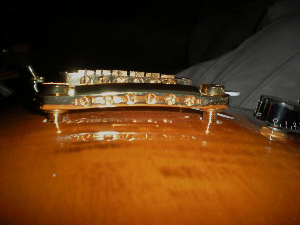

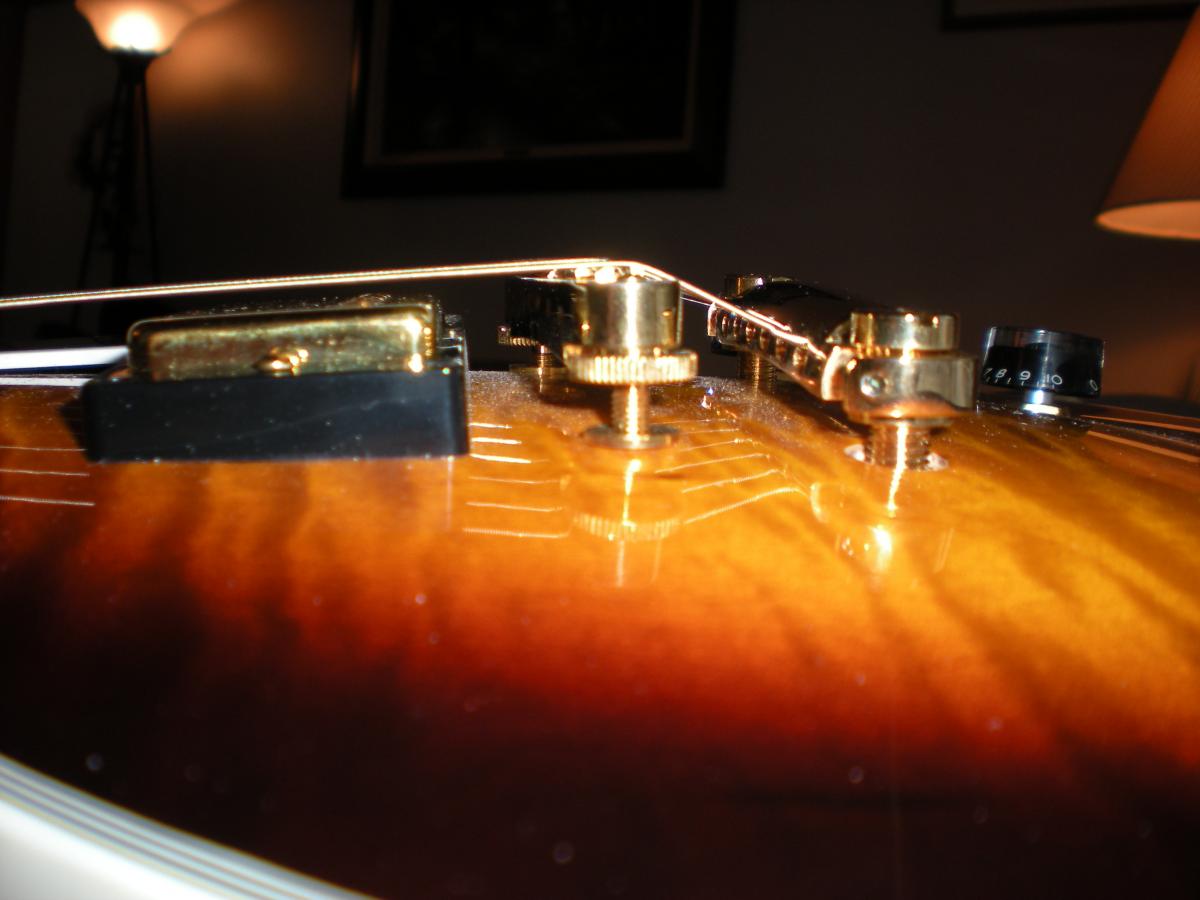

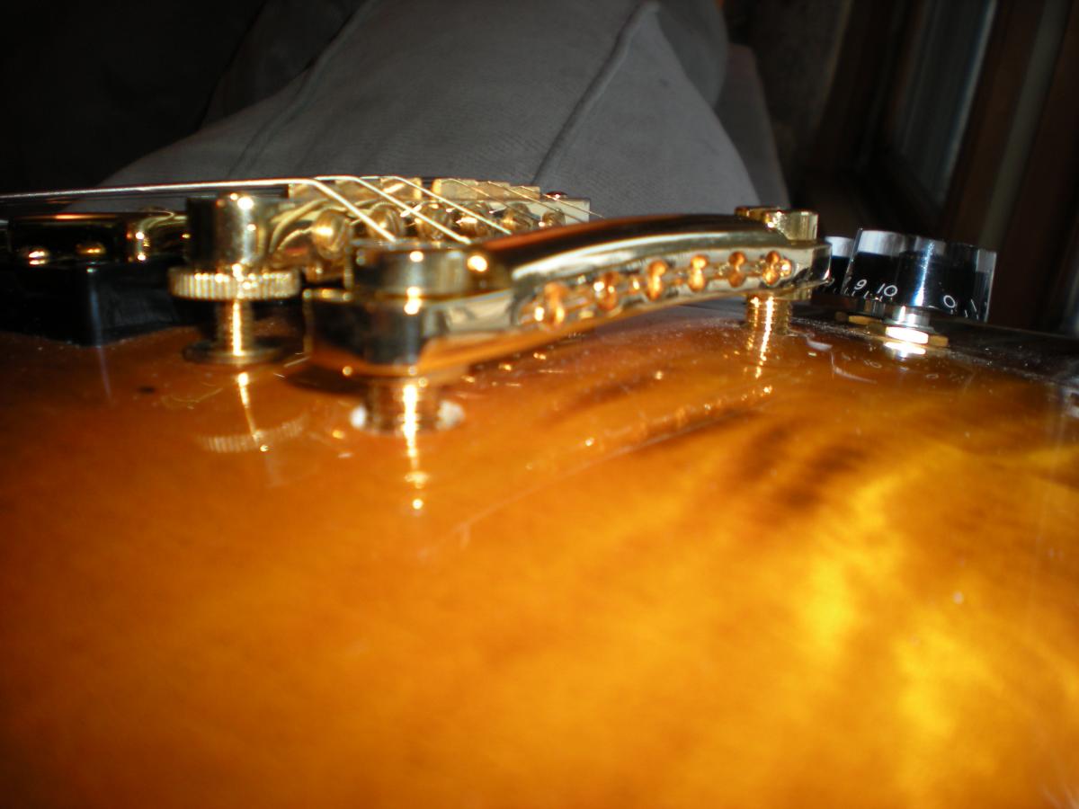

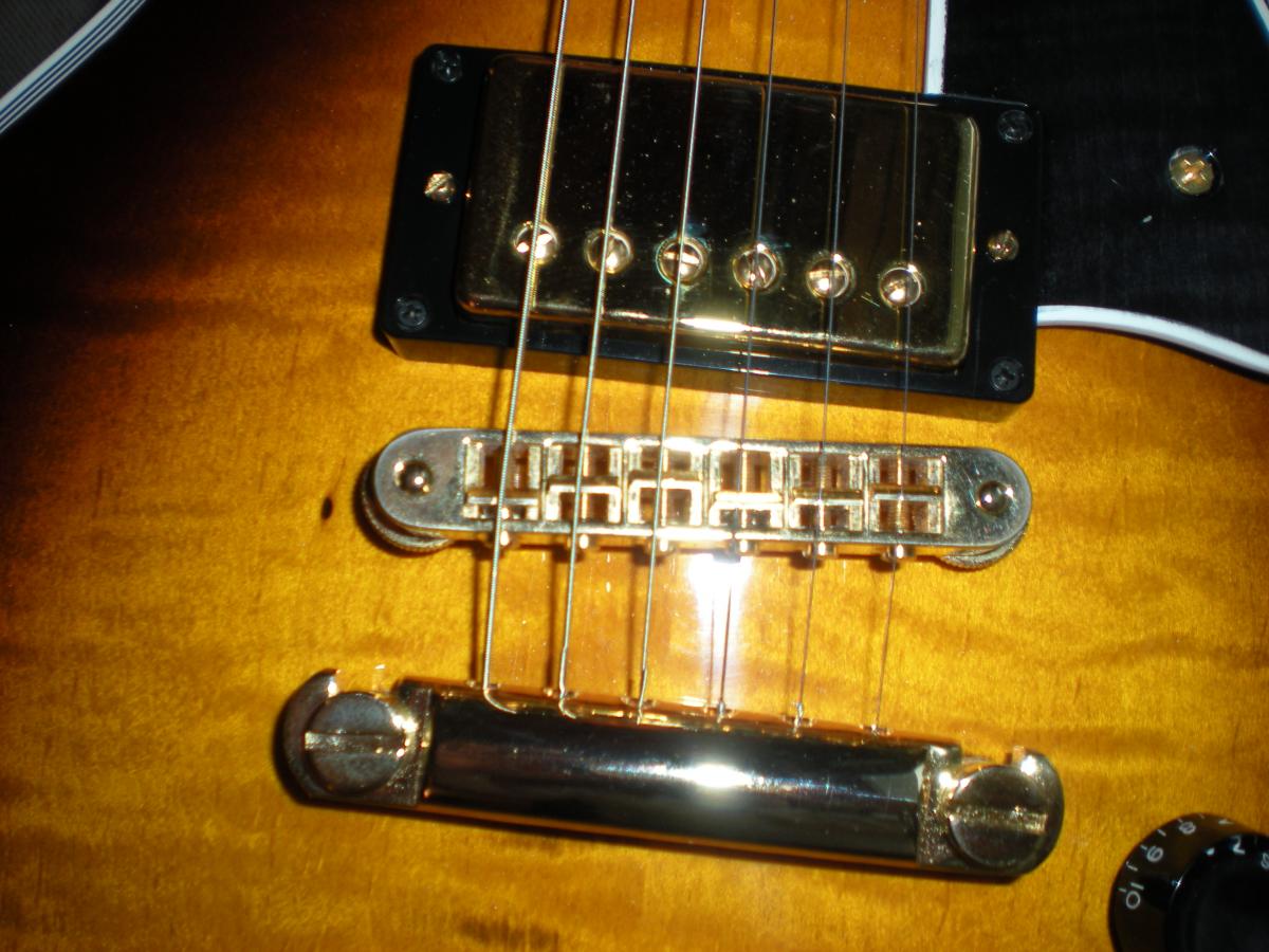

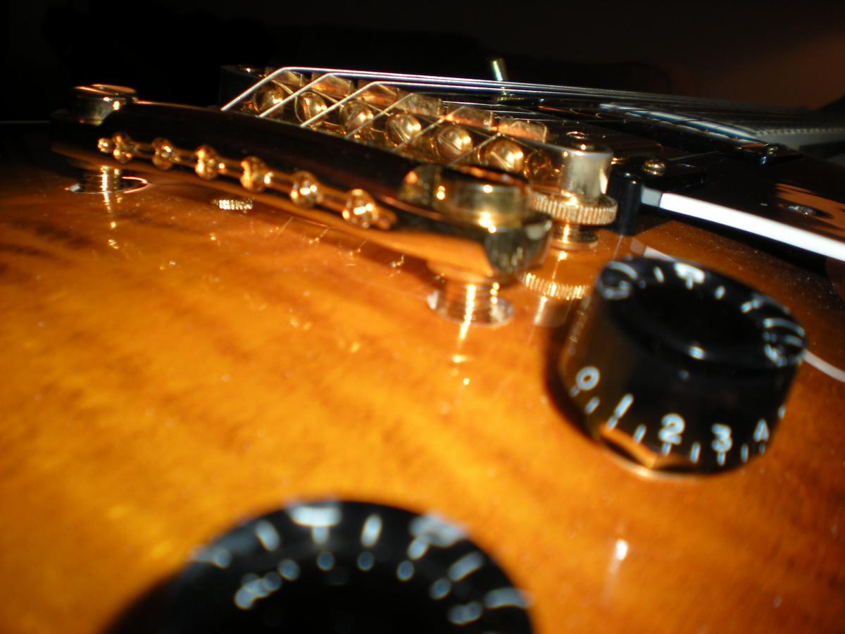

jackhicks Posted December 11, 2012 Author Posted December 11, 2012 I heard from Heritage and they said that a top wrap is "normal" for a Tone Pros bridge and tailpiece. Here's some photos.

fretless Posted December 11, 2012 Posted December 11, 2012 I heard from Heritage and they said that a top wrap is "normal" for a Tone Pros bridge and tailpiece. Here's some photos. Is that the stock bridge or the Gibby ? It looks like you have more room to raise the tail ,just a hair will get the string off the bridge base and it looks like there is more room to adjust the saddles to get it intonated .

jackhicks Posted December 11, 2012 Author Posted December 11, 2012 Yes this is a Gibby bridge. I took the tonepros off because I couldn't get it to intonate. All of the saddles were flipped on the Gibson. Both the Gibson and the Tonepros hit the strings before making contact with the saddles. I guess my options are to keep the tailpiece high, or wrap it.
Hfan Posted December 11, 2012 Posted December 11, 2012 Yes this is a Gibby bridge. I took the tonepros off because I couldn't get it to intonate. All of the saddles were flipped on the Gibson. Both the Gibson and the Tonepros hit the strings before making contact with the saddles. I guess my options are to keep the tailpiece high, or wrap it. or take a file to the offending surface of the bridge usually only the e strings hit if my memory serves. I use a piece of standard 20 wt paper to check. Too lazy to go get the spark plug gapper.

Spectrum13 Posted December 12, 2012 Posted December 12, 2012 Hard to tell. With a hand carved top at times the dish can cause a steep drop from the bridge studs to the anchors on the stop tail. The neck set can be fine. The bridge height looks ok to me. I would place a Farber style bushing on the tail stud to prevent rocking torque or top wrap it.
Balladeer Posted December 14, 2012 Posted December 14, 2012 From the picture, it looks to me like the bridge is not absolutely vertical but leans very slightly towards the neck. If that is the case, then when the tailpiece is close to the body, that could cause the strings to touch the body of the bridge before going over the saddles.
