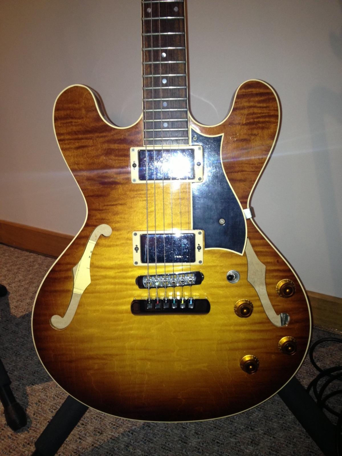

Berts56 Posted December 12, 2012 Posted December 12, 2012 Not a long time Heritage owner but did own a new 150 prior to a separation with it and my ex-wife. Looking at a used Prospect at my local shop. They are good folks and let me live with it for a week or so to test drive. Love the guitar, very much, but find as I play, a small amount of what feels like dirt/grit accumulates on the neck, I wipe it clean with a cloth and keep going. It comes back! I've gently cleaned the back of the neck and tried a touch of finish cleaner/shine. Comes back. Any ideas? Is the finish (nitro-cellulose as I understand) breaking down? Can it be restored if so?
