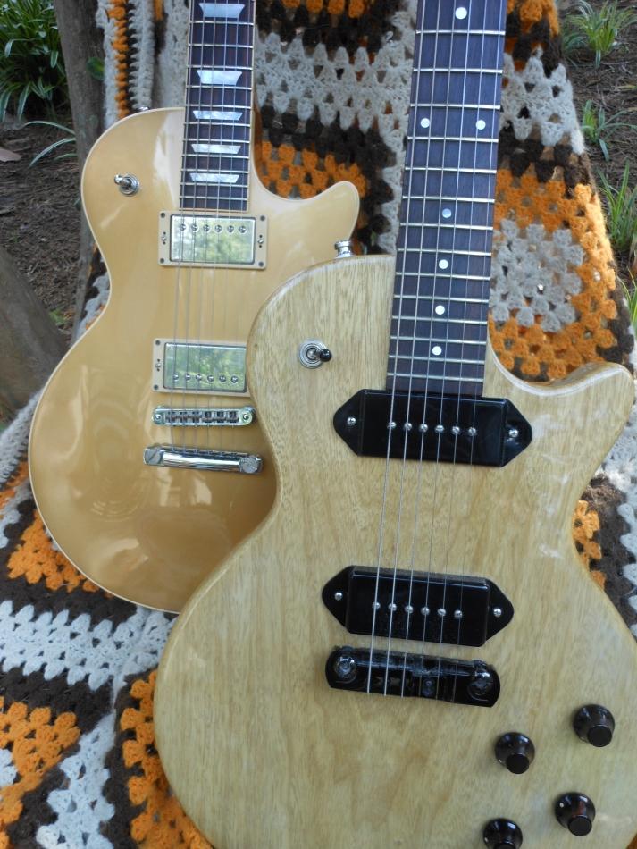

Spectrum13 Posted January 4, 2013 Posted January 4, 2013 In Black installed on a 137 One other option is the Wilkinson GTB bridge. It allows you to intonate the G and B strings. They aren't expensive, so if you can't find the PRS, this might be an option. http://www.eyguitarmusic.com/Wilkinson-GTB-Lite-BridgeAluminium_p_885.html This is what it looks like mounted on a 137.
