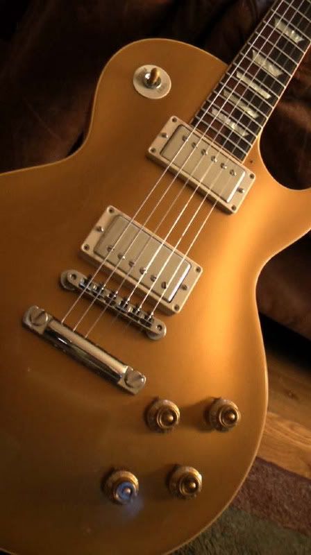

rockabilly69 Posted February 4, 2013 Posted February 4, 2013 As a lot of you guys know I just bought a new H150 with all the cool custom specs from Jay at Wolfe Guitars. One of the reasons I did this had to do with my curiosity on just how good the new H150's are. More than once I've seen reviews where people say H150's are as good or better than production Gibson Les Pauls, but not as good as the historics. Well my 2006 H150, after tweaks by me, seems to hang with my '60 reissue just fine. But to get it there, the bridge needed work, the tailpiece was replaced, the frets needed attending to compensate for a rise in the fingerboard, a new nut needed to be made, the electronics were swapped out with a complete RS kit, and new pickups installed. Now it happens to be my favorite guitar and has a very vintage LP voice, but with all those changes I really can't compare it to my bone stock '60 reissue. But now I can take my new guitar and compare it head to head! And, just to get it out there, this Historic is one of the best I've ever heard in a bone stock example! Now a used Gibson '60 reissue with this kind of flame would go between $3000 and $4000, depending on condition, my new Heritage cost me $2240 shipped to my door. If this new Heritage hangs it seems like this can open the eyes of a lot people that are on the fence about which way to go with their guitar money! These guitars both have long neck tenons, and are within a few ounces weight wise. Spec wise they are different here. My new guitar will be here in a few days so I can't post sound clips, but I will! Gibson 60 reissue ABR bridge nonlocking lightweight aluminum tailpiece burstbucker pickups plastic inlays bigger headstock fake bumble bee caps kluson style tuners plastiziced nitro thin 60 style neck carve Heritage H150 tonepros locking Nashville bridge tonepros locking lightweight aluminum tailpiece seymour duncan Pearly Gates pickups pearl inlays smaller headstock spraque caps grover tuners non platiziced nitro slightly bigger med c neck carve

rockabilly69 Posted February 12, 2013 Author Posted February 12, 2013 I've had an R7, R9, and have played many R8's. I think my R7 was a very special guitar in every way. I had an early 150cm with the correct Gibson body shape that was a great guitar too. They can only be judged on a guitar by guitar basis. After today's comparison I think is very accurate, but this is what I came up with. The Historic 60 reissue and the H150 were so different in tone they could have been different models. The H150 was much bigger sounding in the mids, but I didn't like the top end as much it was a little sterile, also the lows were better defined on the historic. I would say I prefer the historic for my type of tone, which slightly more resonant and sweet, whereas the H150 thumped the speakers in my amps! For the person who likes to feeI the thump of a closed back cab the H150 would deliver in spades. Also pinch harmonics seemed to jump out of the Pearly Gates. But like I said earlier for my tone (Mick Tayor and Jimmy Page inspired styles), I prefer the Historic especially in the light crunch tones. To test the tones I used my 64 Deluxe Reverb, 62 Alamo Fury, and a 2009 TopHat Club Deluxe I brought the guitars over to Fed Ex, and weighed both the Historic 8lbs 14oz, the H150 9lbs 6oz. The weight could have contributed alot to the difference in tone. When it came to sustain it really came down to what part of the fingerboard you were playing, but I found less dead spots on the Heritage. Fret work - even up, and neither work particularly great, both would benefit from some further polishing. The fretwork on my Japanese Zemaitis is better hands down! In the finish department, I think it's a tie, they are both excellent. The Heritage seems to have the all of the quality of my Historic and at a much lower price. Potentiometers on both guitars felt the same, and I didn't find much difference in the taper. I also didn't find much difference in the behavior of the capacitors in tonal changes. I like the shape of the Gibson neck better as the 60 reissue is a typical C shape, wheras the H150 also a C, has a slighty assymetrical shape (see pics) towards the heel. I noticed this shape also on my other H150. The new H150 has more of a shoulder which I don't like. I found I was playing better on my historic. My older H150 doesn't have that shoulder! Gibson Heritage After playing each for hours, I think I prefer the historic, but with some tweaking I think I could get the heritage to where I like it. After the comparison, I pickup up my older H150 and I liked it as much as the historic as I love the Zhangbucker pure handwound pickups in that one!
rockabilly69 Posted February 12, 2013 Author Posted February 12, 2013 If I was playing a gig with my 60 reissue, and broke a string and had to switch to my older H150, I wouldn't need to touch my amp and could go on without breaking a sweat. I could not do that with my new H150, they are that different.
