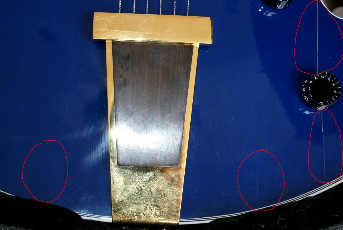

JSSKB Posted February 13, 2013 Posted February 13, 2013 Hi, could anyone help me? I have a beautiful Super Kenny Burrell archtop purchased brand new roughly 2 years ago. After a year some hairline cracks appeared on the guitar's top at the lower bout (they look like typical drying or stress cracks) though the guitar was kept - as all of my high-end archtops - in humidity controlled environment. There was no physical impact to the guitar which could cause those hairlines. First only one hairline crack appeared between the tone knobs and the tail, then more came around that area. I have owned more dozens of solid wood archtops and never ever had such kind of problem. I contacted the seller and then Heritage. I live in Europe so the communication was a bit complicated due to the time difference. Heritage customer service asked for the relevant photos, the details, later the receipt of purchase via e-mail. The whole process lasted for long weeks or even months. They never denied that it could caused by manufacturing issues. But never admitted it either. After a long correspondance finally they just forgot to answer to me. It seemed to be that we reached a certain point where judgement or decisions should be made and they just remain silent. I tried to force Heritage with a few further mails, but got no answer. What to do? Does anyone has experience with such kind of issues? How to handle? How to approach them effectively? the complete thing is more than odd to me, since I have been a fan of Heritage instruments and still own Johnny Smith, Super Kenny and Super Eagle from their product line. I communicated clearly that as well, but they just did not care. I would be very grateful for any help, hint, comment! thanks, Les

TalismanRich Posted February 14, 2013 Posted February 14, 2013 JSSKB Those definitely are not the normal checking. That particular piece of spruce may have an unusually weak point in the grain. Its clearly through the color layer. Have you talked to the dealer where you purchased the guitar? I know that being in Europe makes the situation more difficult, and expensive. As the others said, its best to call in the morning, and I don't think they are there on most Fridays. Good luck, and keep us informed.

hinesarchtop Posted February 14, 2013 Posted February 14, 2013 The cracks are definetly grainline, and are bookmatched which would make me think it was a problem with the wood from the beggining. They are easy to work with. Good luck.
tbonesullivan Posted February 15, 2013 Posted February 15, 2013 that sucks! I hope you can get your issue resolved. Definitely looks like a wood issue. Sometimes wood is like that. No matter how well you dry it before it's used, sometimes it just goes.
