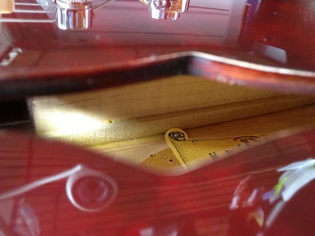

Anyone can suggest how to check if my prospect is floating block or not?
people said if it can pass thro a paper means it is floating block. It seems not for me.

Place finger in the f hole and feel for a gap between the bottom of the block and the back. Should be about a half inch.
I don't think you can see it with a pickup off, the center block is in the way. The only way to really see is through the F holes. Then you can see if there is space between the center block and the back. the top of the guitar is still glued to the center block.
you could also drop a light down thru an F hole & see if it shows under the block, when you look thru the other F hole

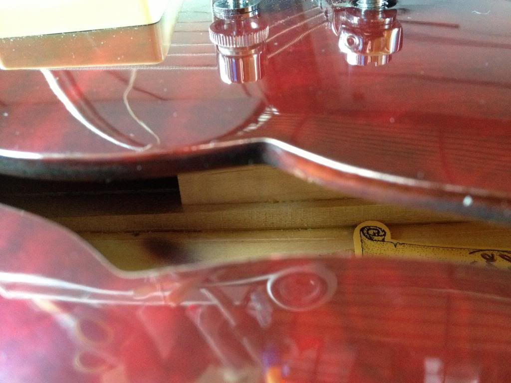

I believe mine is not floating block then. there is no gap at the back... and, i knock the back at the middle area, it sounds solid compared with the 2 side area.
I don't know why i got a solid block actually as i know i ordered a standard prospect.
Well there is definitely a glue line there
My prospect had a floating block there was about 1/4 to 1/2 inch gap
Maybe they've changed the specs?
That's definitely not floating, just had a look at my own Prospect and it's a floating block with maybe 1/4" gap between the block and back of the guitar. Also checked my 535 and that looks the same as the pics above, i.e. no gap, not floating.

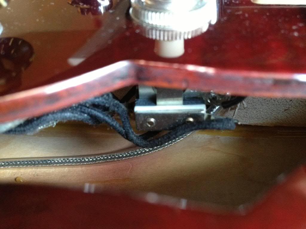

Hmm, interesting. Normally the cutout for the electronics would be only visible from one side. Is the center block just missing forward of the bridge pickup?
with the prospect, they get the "floating gap" by omitting the kerfing they use to bridge the gap between the center block and the top.
I'm assuming you've seen this, but just in case, read the sellers description in the original post. Prospect with a "full solid center block"
It at least illustrates that there is precedent for this. Sorry if that wasn't what you were looking for. Still a great guitar, no doubt.
