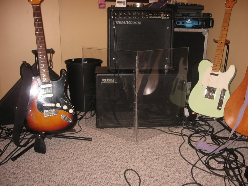

plexirocker 68 Posted February 23, 2013 Posted February 23, 2013 just go to lowes or home depot. get 2 18x24 1/4" sheets of lexan, packing tape the center seam, folds to a 1/2 inch thick, lightweight. I never leave the house without it, works GREAT and way cheaper than the clearsonic panels, under 40 bucks plexi

DetroitBlues Posted February 23, 2013 Author Posted February 23, 2013 just go to lowes or home depot. get 2 18x24 1/4" sheets of lexan, packing tape the center seam, folds to a 1/2 inch thick, lightweight. I never leave the house without it, works GREAT and way cheaper than the clearsonic panels, under 40 bucks plexi Does that really work?

plexirocker 68 Posted February 24, 2013 Posted February 24, 2013 Does that really work? yes you can't make a final decision by the clearsonic panel vid, try it, sure it soften the highs but you can move the panels around to open the sound up some more and keep your stage volume down and from "spreadin the stage" the biggest thing it lowers stage volume and in smaller places it helps our out front sound immensely I'm a big amp loud kinda guy but since using this it really helps a lot in real world sound solutions man, it's a cheap thing to try plexi

rockabilly69 Posted February 25, 2013 Posted February 25, 2013 I always say the wattage needs to be right for the gig. I would rather have many amps and a few gtrs than vice versa. I surely can't see putting plexi up in front of a multi speaker rig. Isn't that why you buy a multi speaker rig, for coverage??? For smaller gigs I use lower wattage amp that can be cranked with an ext cab for coverage. I also like inefficient speakers! My 18 watt clone just gets dirtier when it gets past 5 which isn't loud to begin with. In tough situations I let my pedal board do what the amp can't.
