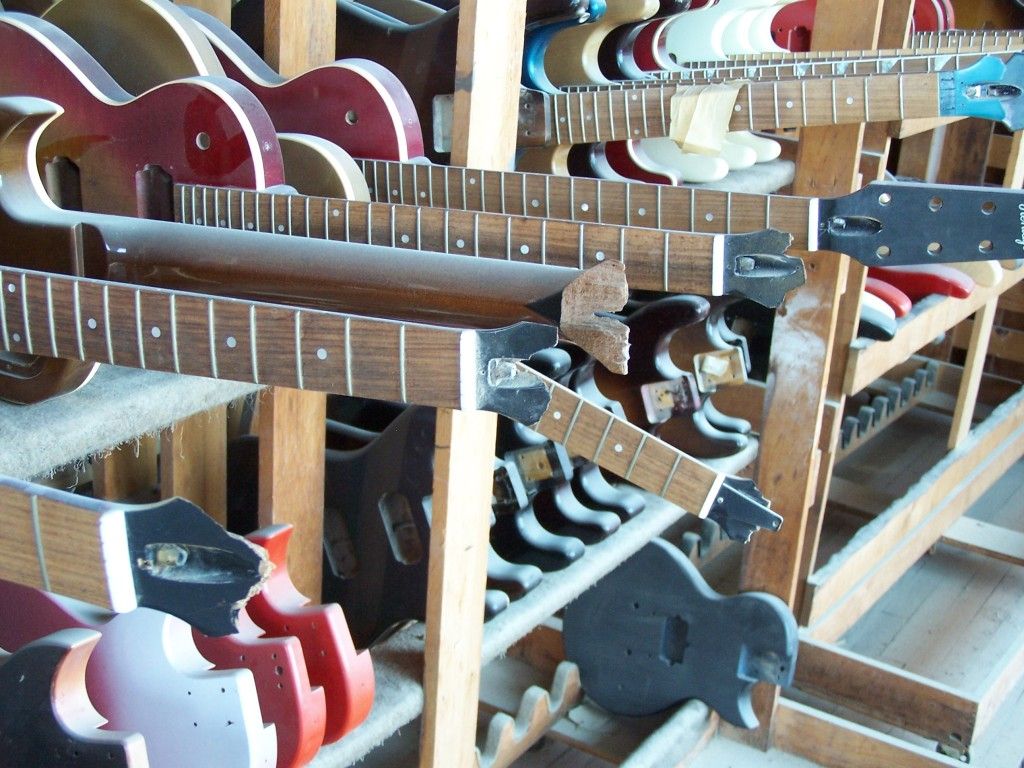

Yeah, um, accidents CAN happen... I agree with what's been said here; while not optimal, the broken headstock 170 I bought from Brent 2 years ago is solid as a rock, and I got a good price on it because of the break. Here's a few that are upstairs at 225 Parsons Street; I don't know if the boys just don't have the heart to destroy them, or if they had plans to ever fix them, but I'll bet they still are right there next year... and the next.....
This picture is both depressing and fascinating to me and leads me to ask the question......would Heritage sell any of these broken beauties?
The reason I ask is that I've got a visit to 225 Parsons St planned for the end of the month and would love to buy a guitar while I'm there, preferably a playable guitar but are on site purchases at Heritage even a possibility?
Heritage won't sell you a guitar unless you go through a dealer. They WILL let you order a custom build from a dealer and pick it up at the factory. Several HOC members have done that. Last year at PSP, Eljay did that with his 357.
