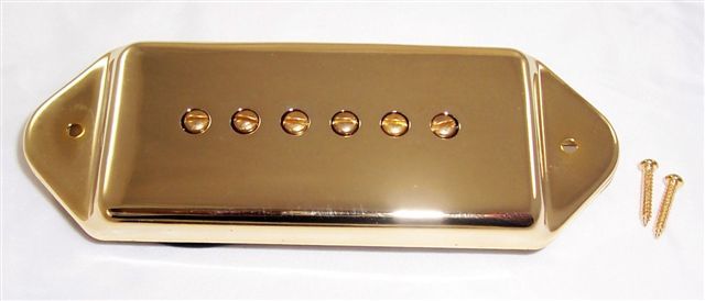

MartyGrass Posted March 4, 2013 Posted March 4, 2013 My Super Eagle has a tailpiece that is designed to hold the strings only by tension. The ball easily slides out of place if there is a release in string tension and sometimes pops out during the initial tuning of a new set of strings. This TP design is about 80 years old and has been used in Gibson's early archtops. Here's a pic of an old L5 TP. Note that the string slot does not have any means to retain the ball except tension and slight friction. Over years, the slot edge can become rounded and is even less secure. This one looks like there is more of a lip on the slots to hold better. I've asked my luthier to improve the Gibson/Heritage design. He plans to drill small concavities that will capture the ball. He has an old tailpiece that he will practice on before working on mine. That is very thoughtful. While he has the guitar, I've asked him to put some gold pickup covers on it. I happen to have a new pair. I doubt they will look good, but they didn't cost me anything. If they do look good, I'll have to find gold screws.
