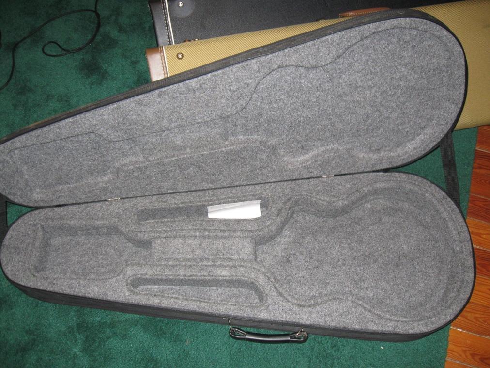

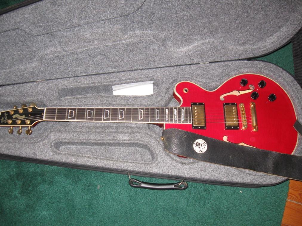

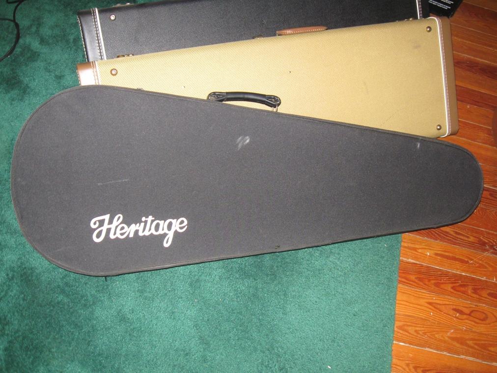

drewzee87t Posted March 25, 2013 Author Posted March 25, 2013 Pics would help.... Case outside and inside. Guitar in case. I can't get a good photo of the finish on the back of neck. The damage finish is between 2nd and 13th fret exactly where the neck rests on the support in the case.
big bob Posted March 25, 2013 Posted March 25, 2013 All the 2000 Millie's came with cases like that. I had one that rich has now. I never had a problem with it. As for the email sounds like classic Ren Wall, short and sweet. I can't imagine he'd was intentionally being rude. I think if the guitar has lived in the case for 12 years w/ o problem the culprit is probably something other than the case. What type of cleaner do you use?
drewzee87t Posted March 25, 2013 Author Posted March 25, 2013 I have been using Smith pro formula on all my guitars for the last twenty years and never had a problem with any of them. The damage is limited to where the neck was in contact with the case. I think the foam under the neck support is gassing out after twelve years. Foam is kind of unpredictable with age. Glad to find someone that has seen another of these wonky cases.

mars_hall Posted March 25, 2013 Posted March 25, 2013 So was the case or guitar ever sprayed or did it ever come in contact with any reactive agent, such as an odor killer, alcohol, fabric softener, or water etc? You believe the case to be the source of contaminant, and it may have been, but the solvent could also have been introduced externally before the guitar was stored. The points of contact of the guitar to the case would serve to preserve a reacting agent. Where was the case stored?

hinesarchtop Posted March 25, 2013 Posted March 25, 2013 If it has only reacted in the area of contact you're probably right in that it's gassed off causing the finish problem. I would not be overly concerned about the short email as that's what is fairly standard for them. Just call early in the morning and explain in detail. They are usually good about problems. In fact, they stood behind me with a huge problem with an Ed Roman order and made it more than right. They also may have not understood what type of case you were describing. Best of luck.

Millennium Maestro Posted March 25, 2013 Posted March 25, 2013 I have had the exact same case and with the exact same guitar and although I never put my guitar into hibernation I had the same results to the finish on the backside of the instrument and your description makes yours situation sound more extreme I resolved my issue personally by hand polishing the backside instrument.... I do not believe it to be a burn into the finish as mine was not burnt into the finish, more of a residue left adhered to the finish and recommend you trying to hand buff out the residue first. - I also fit a T-shirt into the case as a buffer between case materials and the guitar and it never happened again. I live in Vegas and everytime I call my questions get answered, I also am NOT a fan of the zip up soft/hard case. I WANT TO SEE PICTURES OF BOTH YOUR GUITAR AND THE EFFECTED AREA OF THE GUITAR!
