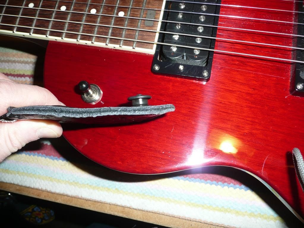

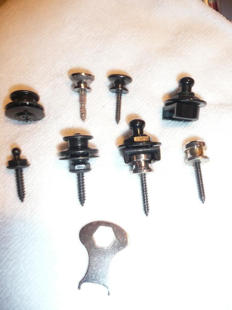

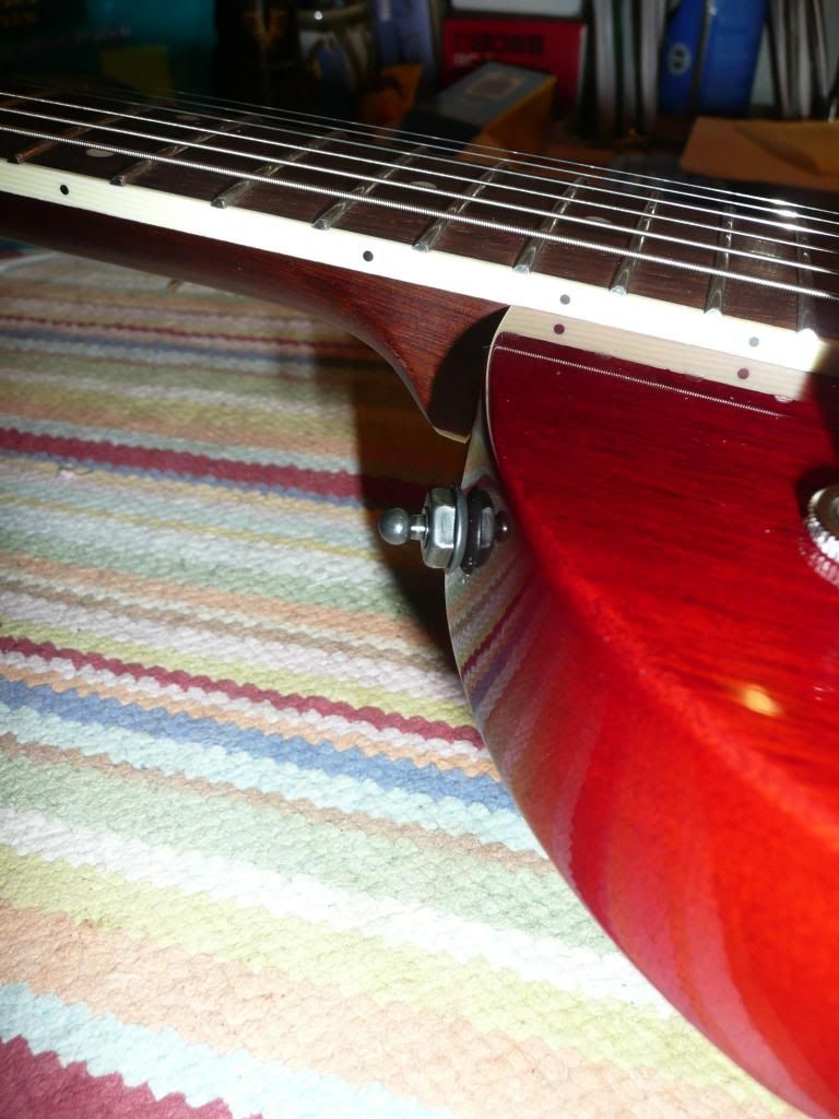

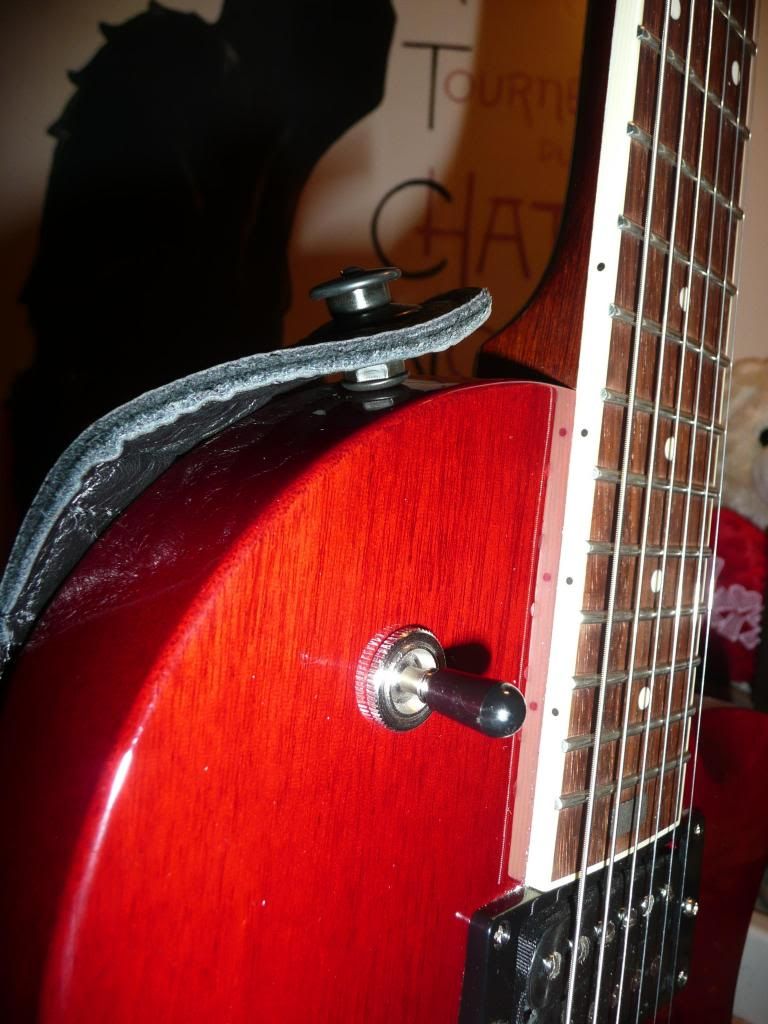

tulk1 Posted May 17, 2013 Posted May 17, 2013 Check out LOXX as alternative to Schaller or Dunlop. These never come loose from the strap, go on and off easier than any other lock I've ever used, and they just ... work! BTW, on my 555 and Prospect I install the strap bit in reverse to say a 150/157. Helps the strap lay flatter, brings the guitar in closer to the body.
kidsmoke Posted May 17, 2013 Posted May 17, 2013 Check out LOXX as alternative to Schaller or Dunlop. These never come loose from the strap, go on and off easier than any other lock I've ever used, and they just ... work! BTW, on my 555 and Prospect I install the strap bit in reverse to say a 150/157. Helps the strap lay flatter, brings the guitar in closer to the body. +1 on Loxx
kidsmoke Posted May 17, 2013 Posted May 17, 2013 other nice thing is the Loxx are just a lot less metal, and the screws may be a bit wider...
