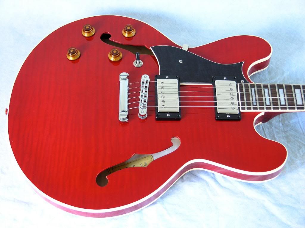

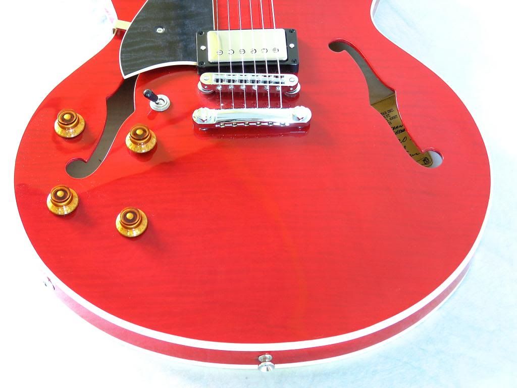

ely Posted May 21, 2013 Posted May 21, 2013 Hi All, Received a new Heritage h535 as described above. How would 535 owners describe the paint around the sides of the guitar and at the back(where the strap nut is) in terms of quality/uniformity. I know they are hand sprayed but I wouldnt call the paint, tidy work with no flaws. Comments. Also the belt screw in the tail of the guitar is not quite flush and there is a small crack with a poor paint job over it where the screw was put in at a slight angle - no flush to the back of the guitar. Also the nut is barely cut - so not really holding strings in palce or setup at all, is this the Norm. Anyone else encountered these issues. Thanks, Ely

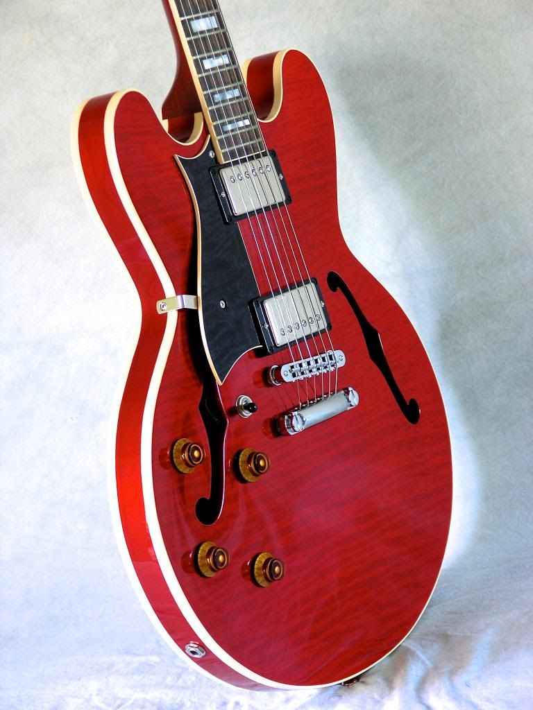

ely Posted May 21, 2013 Author Posted May 21, 2013 Hi Kenny, Cheers for that. Here's a pic of the guitar from the website I bought it. http://s228.photobucket.com/user/jerrysleftyguitars/media/Heritage/Heritage%20535%20Trans%20Red%20Custom%20left%20handed%20guitar/PC198289_zps251c083a.jpg.html?sort=3&o=4 You can see the discoloration to the left of the strap screw and the dark shadow where the screw is slightly raised and to the right. Problem is I'm in Ireland. Bought the guitar in America. I agree the nut should be setup before shipping, they cost enough. I was kinda expecting something special, the one off bankroll busting guitar, not sure how I feel. If the strap screw was fine, I prob wouldnt mind the iffy paint jib, the nut I can get setup. Cheers
tulk1 Posted May 21, 2013 Posted May 21, 2013 Aha!! You got that from Jerry's. Jerry has a great reputation. Contact the man, express your disappointment. Hopefully he will work something out. Yeah, bottom line it should never have gone out like that. But as long time owners and Heritage lovers, we know it happens. Maybe one of our Ireland HOC members will reach out to you, as well. Might be something they can think of to help.

Blunote Posted May 21, 2013 Posted May 21, 2013 Beautiful guitar! Unlike some of the others, I can't see the issues you mention from the pics. Regarding the paint, could that be the along the line where the binding edge meets the paint? I had the nut fixed on the H150 I bought new. Mine was also cut shallow except that the G string was too deep. A problem I've noticed in more than one Heritage. Apart from that, a solder joint on the output jack was faulty. Both were very minor fixes that the boys at Parsons Street took care of.

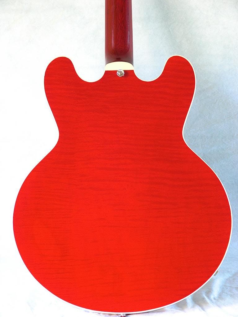

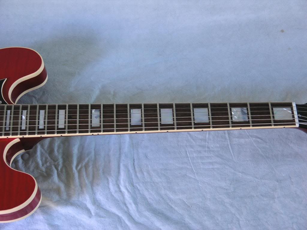

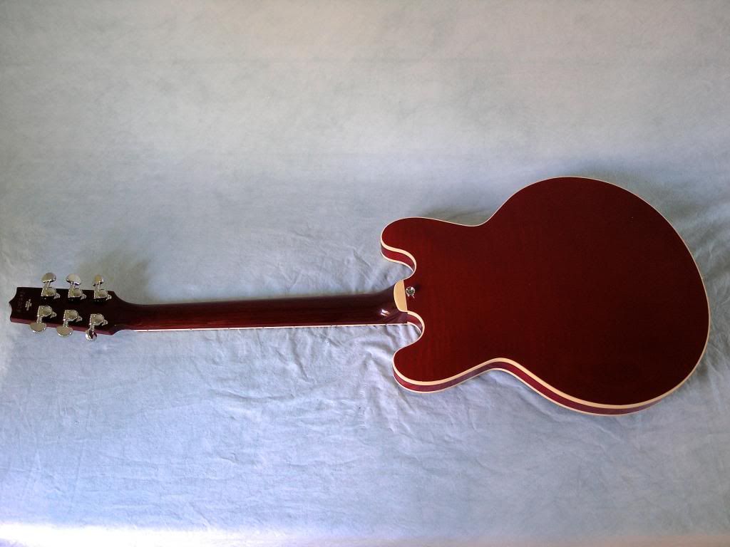

ely Posted May 21, 2013 Author Posted May 21, 2013 Thanks Bluenote for the extra large photos. Thats her alright. In Pic 4 of the guitar base you can see to the left of the strap nut a discoloured line/small mark, a small crack runs from the screw, you can see that the nut is not sitting flush on the left hand side from the shadow . In pic six you can see an example of the paint issue on the side where the red meets the binding half way between the pots. Anyway thanks for all the good will from the HOC. Cheers Ely

Blunote Posted May 22, 2013 Posted May 22, 2013 Ok, I see what you're talking about. The paint edge thing is common enough. I think that's from when they scrape the binding after the guitar is painted. It's a manual operation that is sometimes less than perfect. If not that then I suppose it could be a smear from buffing if the paint wasn't completely cured. Some of the others here who are more familiar with the process could elaborate. The crack and button should be repaired. Heritage would probably have you go to a competent luthier local to you. The crack can be glued and clamped so as to be invisible afterwards and just as strong as it ever was. The screw hole can be plugged & redrilled; would be worth doing if just to fit a strap lock button IMO. If it were my guitar, I wouldn't be too upset.
