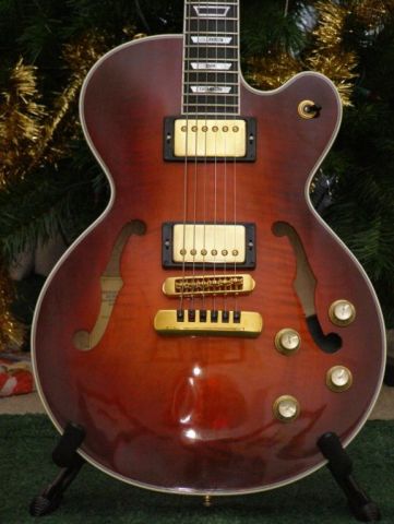

jjkrause84 Posted June 30, 2013 Posted June 30, 2013 Hey guys. Looks like I might be rejoining the club very soon! The only bummer: the 535 in question has one of the older-style hideous tailpieces. Can this be replaced with a tradition G-brand looking one?
111518 Posted June 30, 2013 Posted June 30, 2013 H gets all credit for this ... I just searched for the most recent discussion that answered the question... H wrote: I've posted this so many times, I think it should get pinned to the top of this section like the serial number post! Metric bridgeImperial tailpieceGotoh GE101 and GE103 set.Tonepros LPNM04 set (T3BP bridge, T1ZS tailpiece) - the 'N' in the code denotes nickel.The same parts fit any Heritage model with a Schaller stop-tail and roller bridge. It's a straightforward swap which will take you all of 20 minutes including removing and reloading strings.

jjkrause84 Posted June 30, 2013 Author Posted June 30, 2013 Thanks, guys! So, metric bridge, imperial tailpiece. What about the Tailpiece studs? Can I use the ones that the guitar already has? BTW, if anyone wants to know what she looks like... http://www.ebay.co.uk/itm/HERITAGE-H-535-/181167588122?_trksid=p2047675.l2557&ssPageName=STRK%3AMEWAX%3AIT&nma=true&si=2xSRrG7wF0djK%252BxVfgOgtoVNrZU%253D&orig_cvip=true&rt=nc

H Posted July 1, 2013 Posted July 1, 2013 Looks like mine, JJ A beaut and a good price too! Regarding the tailpiece studs, it was a while ago but I seem to remember that the locating 'head' on the stud is smaller for the Schaller tailpiece, necessitating a change.
111518 Posted July 1, 2013 Posted July 1, 2013 Hmmm... I replaced mine with Imperial Bridge and Tail Piece. Why would Heritage use metric in the first place? And then why would the use a metric bridge and an imperial tail piece? That doesn't make a bit of sense to me. Like I said imperial bridge/tail piece went on all of my Heritage's that had the Schaller roller bridge/beast tail piece standard. H's answer is perfectly adequate, I think --that's how Gibson did it. But maybe (just speculation) the explanation of why is that when Gibson shifted from the ABR to the "nashville" bridge, made by schaller, those bridges were metric, while Gibson continued to use imperial tail pieces, producing the odd combination. My speculative 2 cents, of course --although we know Gibson was famous for finding ways to use up old parts, which produced odd combinations and inconsistencies. (The measurements are very close, although I would think the threads of the inserts/posts might be an issue.)
H Posted July 1, 2013 Posted July 1, 2013 H's answer is perfectly adequate, I think --that's how Gibson did it. But maybe (just speculation) the explanation of why is that when Gibson shifted from the ABR to the "nashville" bridge, made by schaller, those bridges were metric, while Gibson continued to use imperial tail pieces, producing the odd combination. My speculative 2 cents, of course --although we know Gibson was famous for finding ways to use up old parts, which produced odd combinations and inconsistencies. (The measurements are very close, although I would think the threads of the inserts/posts might be an issue.) Perfectly correct. Schaller invented the Nashville bridge and, being a European country, produced it with Metric sizing. Perfectly correct. Schaller invented the Nashville bridge and, being a European country, produced it with Metric sizing.European company, not country
