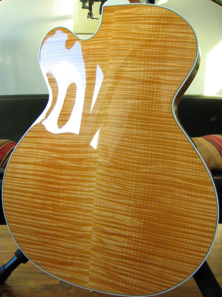

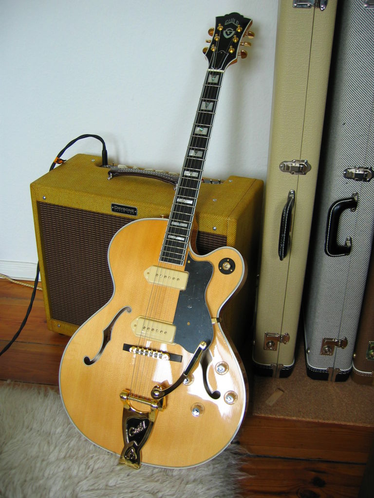

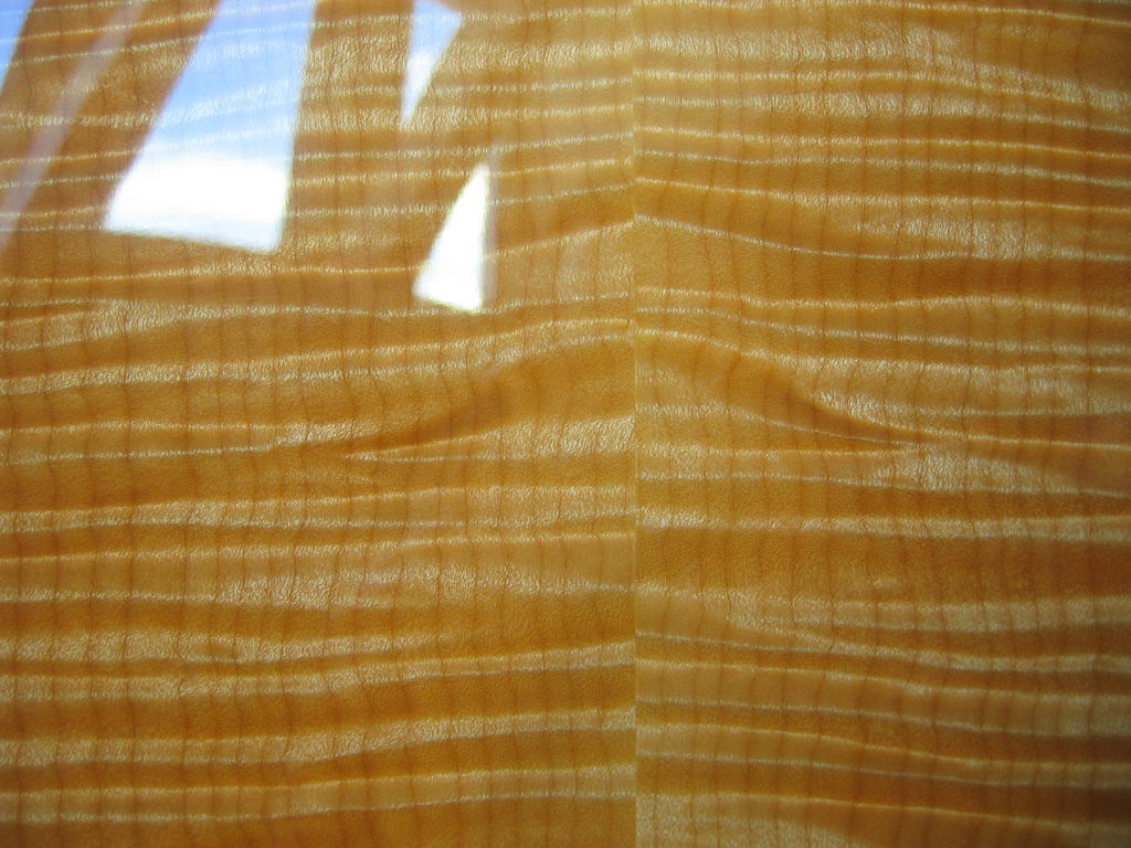

SofaPlayer Posted July 26, 2013 Posted July 26, 2013 myself I prefer nitro over poly: for breathability, plus i like the aging effect as it takes on the woodgrain texture over time ....could I hear a difference between a pure nitro vs nitro with added plasticizers? I'm not sure but the purist/traditionalist in me would take nitro given the choice. especially over the 1/4" thick shells that a lot of poly guitars get otherwise I'm inclined to take the advice of some guys who have been handbuilding guitars for over half a century Yikes. Twice +1 Interesting topic. I didn't know that additional layers bring out the 3D effect better. So I guess my Guild T-500 has quite a few extra layers. Still very happy how it resonates, I doubt that I'd hear the difference to fewer layers. That said, I prefer the traditional nitrocellulose formula without the plasticizers. I don't mind at all to see my guitars age gracefully, quite the contrary.

SouthpawGuy Posted July 26, 2013 Posted July 26, 2013 Twice +1 Interesting topic. I didn't know that additional layers bring out the 3D effect better. So I guess my Guild T-500 has quite a few extra layers. Still very happy how it resonates, I doubt that I'd hear the difference to fewer layers. That said, I prefer the traditional nitrocellulose formula without the plasticizers. I don't mind at all to see my guitars age gracefully, quite the contrary. G1.JPG G2.JPG G3.JPG Awesome wood in that one ! .

SouthpawGuy Posted July 26, 2013 Posted July 26, 2013 haha, nice!! here's an example What guitar is that ?
Steiner Posted July 26, 2013 Posted July 26, 2013 What guitar is that ? The owner's name is Nick. He's a flake...
SouthpawGuy Posted July 26, 2013 Posted July 26, 2013 The owner's name is Nick. He's a flake... Nick Cadbury ? Hadn't heard of him
