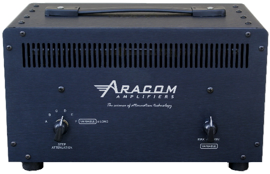

Blunote Posted August 31, 2013 Posted August 31, 2013 Keep your eyes open for one of these: Hands down the best attenuator I've ever plugged into. Does not color the tone at all. I think everyone should have a decent attenuator that allows you to choose the amp you really want and play it set up to it's sweet spot at any volume level. They aren't cheap and don't come up often. This one sold used on ebay earlier this month for $375. But over a lifetime of playing, I think being able to use the gear you love best makes it well worth while.
Blunote Posted August 31, 2013 Posted August 31, 2013 Update: In my exuberance to find a solution to your problem, I did a search for an Alex at TGP and found an 8 and 16 ohm for sale for less than $300. I pulled the trigger on the 8 ohm one. So, I guess I'm taking my own advice, eating what I cook...you know. There's still one or two of the 16 ohm versions that might work; I'm told the 8 ohm Alex will work for 16 ohm speaker loads as well. Or, if that's too much money, I'll likely have my current attenuator, a stand-alone Dr. Z Brake Lite SA available once I receive the Alex. I'm guessing the price will be less than $150. What I'm saying is....that Heritage amp is too good to let go if there's a way make it work the way you need it to. I hate seeing musicians churning through gear they really want to keep.
Steiner Posted September 1, 2013 Posted September 1, 2013 Blunote - I'd be real interested in your take on that attenuator.
Apprentice Posted September 1, 2013 Posted September 1, 2013 I have this one: I use it with my '65 Blackface Fender Bassman (which has no master volume) & it really helps to bring out the good ol' overdriven blues sound. Also, it has an impedance knob (2, 4, 8, & 16 ohms) for both the INPUT and the OUTPUT. But it is kinda pricey tho. Hope you'll find your attenuator to serve your amp!
Blunote Posted September 1, 2013 Posted September 1, 2013 Blunote - I'd be real interested in your take on that attenuator. A buddy of mine loaned me his last year and I used it for a couple of months. This is the friend who owns GDS and Guytron amps. I used it a lot with my KBP Reverb Deluxe and it allowed me to get the cranked tones I wanted at room volumes without any sacrifice in sound quality. When I returned it, I went back to using the Dr.Z Brake lite which is also very good, but not as heavy duty. The Alex is wired up to more accurately provide a load that is identical to what the speaker provides. For anyone with an EE degree, they'd understand it better than I; for instance, Graydon from GDS/Guytron has one. It provides inductive resistance as well as "normal" resistance that varies with the change in signal strength from the amp. Whatever it does, many consider it the best on the market. You've got some amps it would work well with -particularly the Soldano. edit: By the way, the Motor City Amp show will be on the 21st of September. Put it on your calendar.
