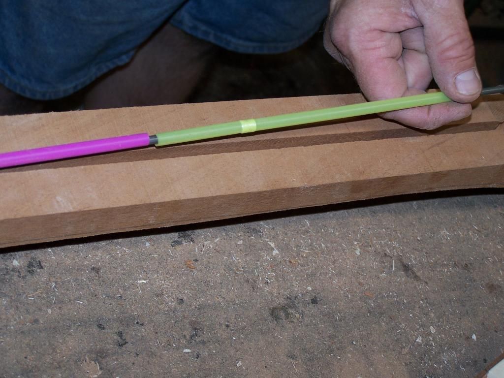

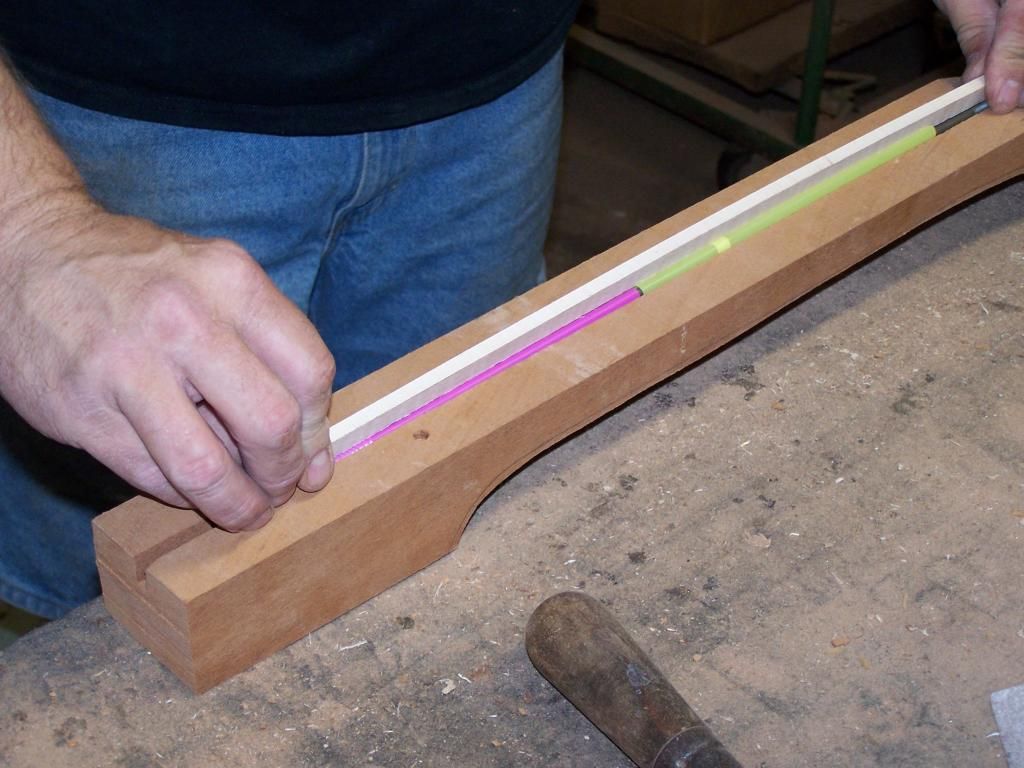

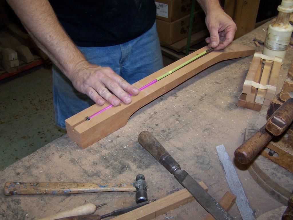

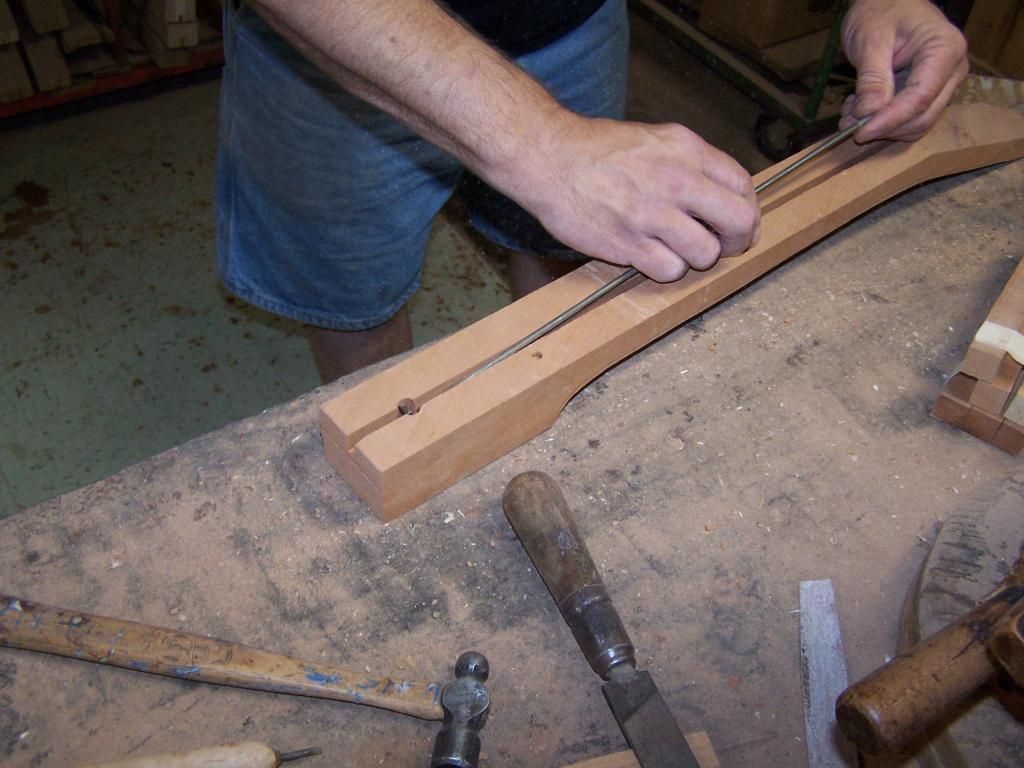

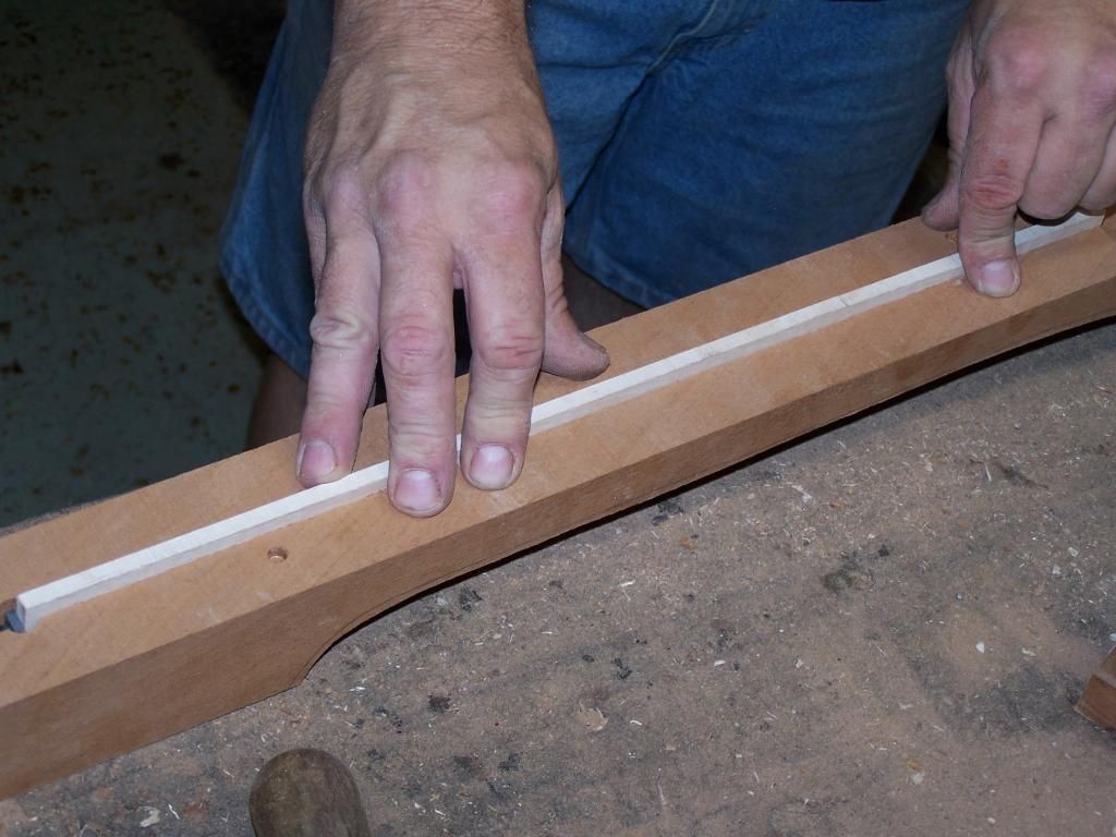

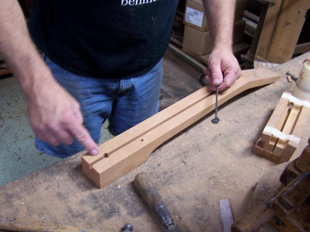

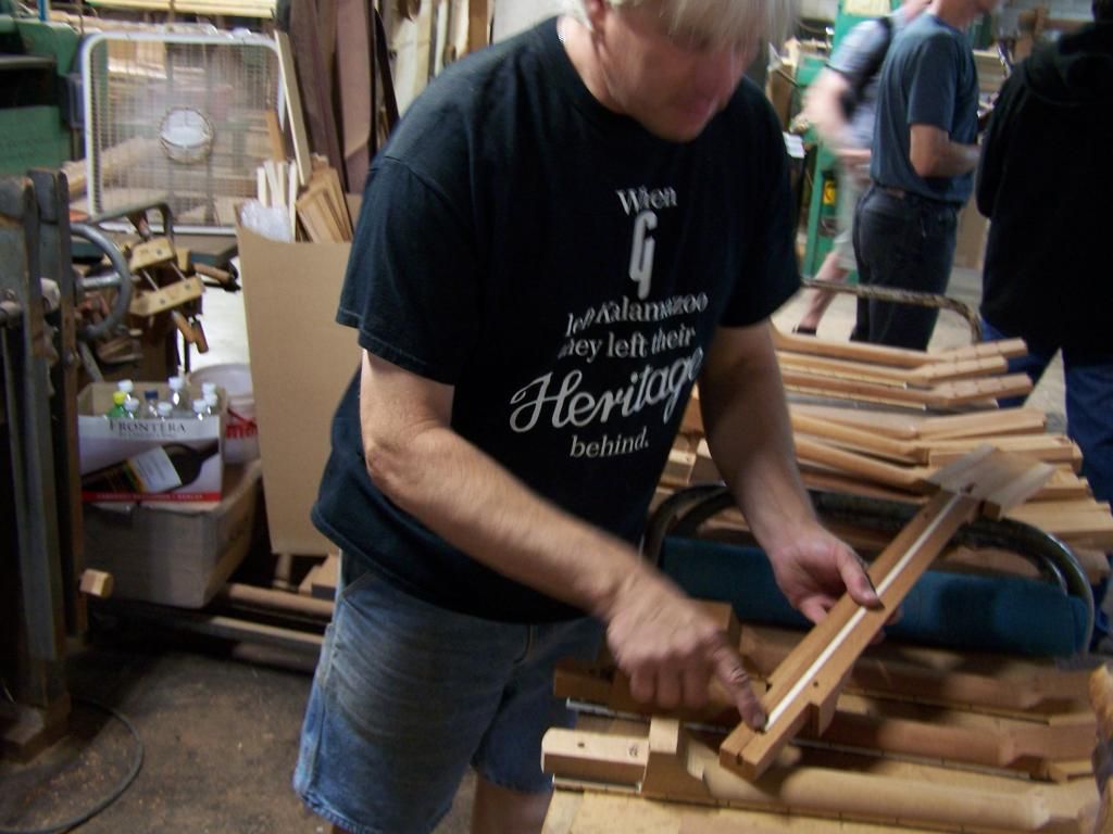

schundog Posted August 24, 2013 Posted August 24, 2013 While touring the plant at PSP earlier this month (was that REALLY still just this month?! It feels like 6 months ago already...) Arnie was showing some of us how they install Truss Rods in the necks. I always wondered how they got them to turn in the neck slot freely. Wouldn't the glue used to attach the fretboard gum up the works? Not if you use the high tech tool used at The Heritage; drinking straws over the top of the truss rod! However, we ascertained that, for the best tone, they needed to be COLORED straws from Meier grocery stores.....

y2kc Posted August 24, 2013 Posted August 24, 2013 Arnie is a great teacher. Heritage has allowed us access and an inside view that is priceless. I saw those straws a few years ago and got a good chuckle. y2kc

chico Posted August 26, 2013 Posted August 26, 2013 man, Arnie, the sausage maker never tells the recipe for making sausage..now this?? nice study trussrod installation with your photos Brian.
holyroller Posted August 26, 2013 Posted August 26, 2013 Great t-shirt he's wearing.i want a shirt just like that !!!!
