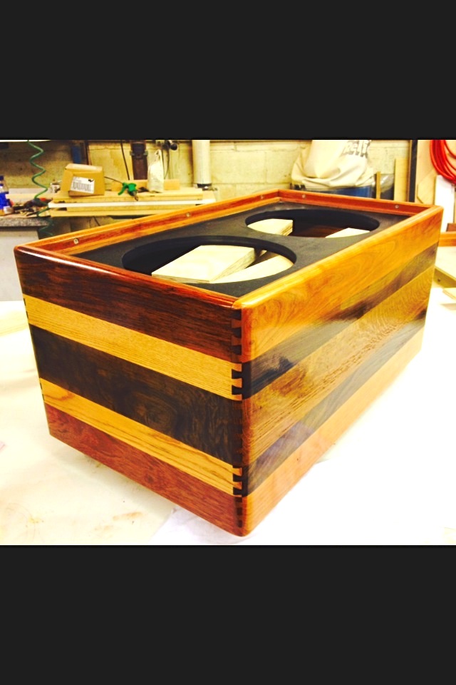

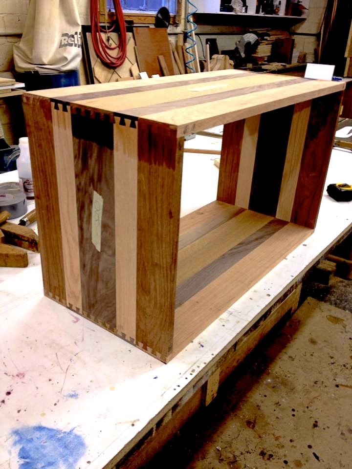

hammerboogie Posted September 25, 2013 Share Posted September 25, 2013 i want a mesa 2-12 horizontal cab, so im building my own, but with a artistic flair, 4 woods, quarter sawn oak, brazilian mahogany,walnut and cherry, alt on the sides and learned how to dovetail today! Link to comment Share on other sites More sharing options...

Steiner Posted September 25, 2013 Share Posted September 25, 2013 Dovetails are a bitch; 'till you get the router set. Then they are quite fun. They add a level of flair and detail - an extra level of attention added to your work. It appears they came out very nice. Congrats! Link to comment Share on other sites More sharing options...

hammerboogie Posted October 4, 2013 Author Share Posted October 4, 2013 thanks guys, it took 4 hrs of messing around to get the jig set just perfect, ive been working on it every night, so as it is now, i routed the dovetails off rounded, then a smaller route of the front and back edges, using 3/4 birch ply on the back fully closed and i got some gold speaker fabric from the a church organ builder so are you ready? here it is with 3 coats of tung oil so far i how do you add a pic? Link to comment Share on other sites More sharing options...

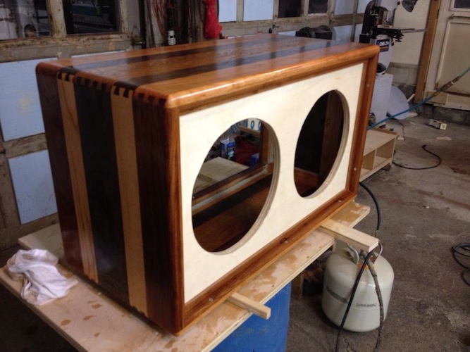

hammerboogie Posted October 4, 2013 Author Share Posted October 4, 2013 OK GOT IT NOW, ITS HARD TO SEE THE GRAIN, THE TOP CENTER BOARD IS QUARTER SAWN OAK Link to comment Share on other sites More sharing options...

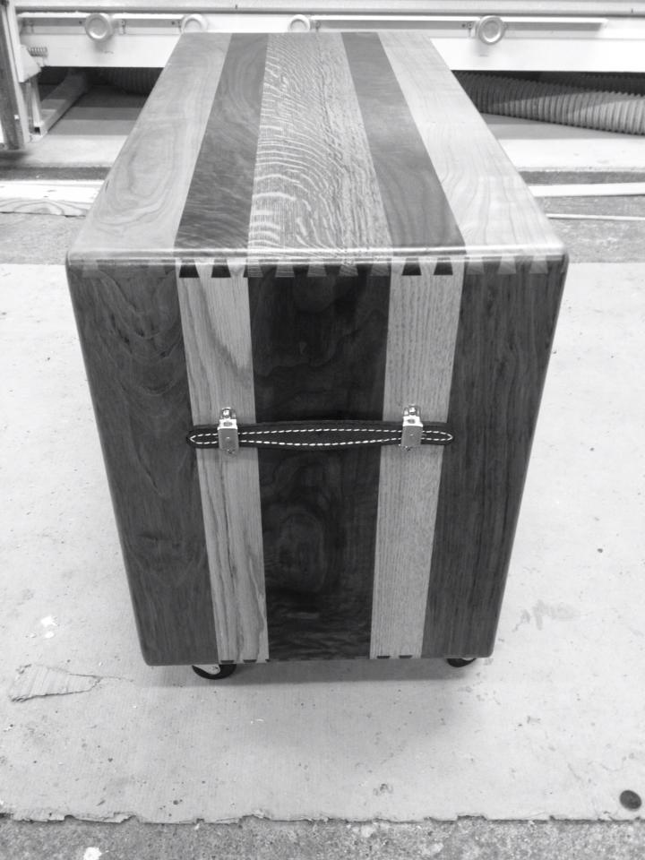

hammerboogie Posted October 24, 2013 Author Share Posted October 24, 2013 Link to comment Share on other sites More sharing options...
