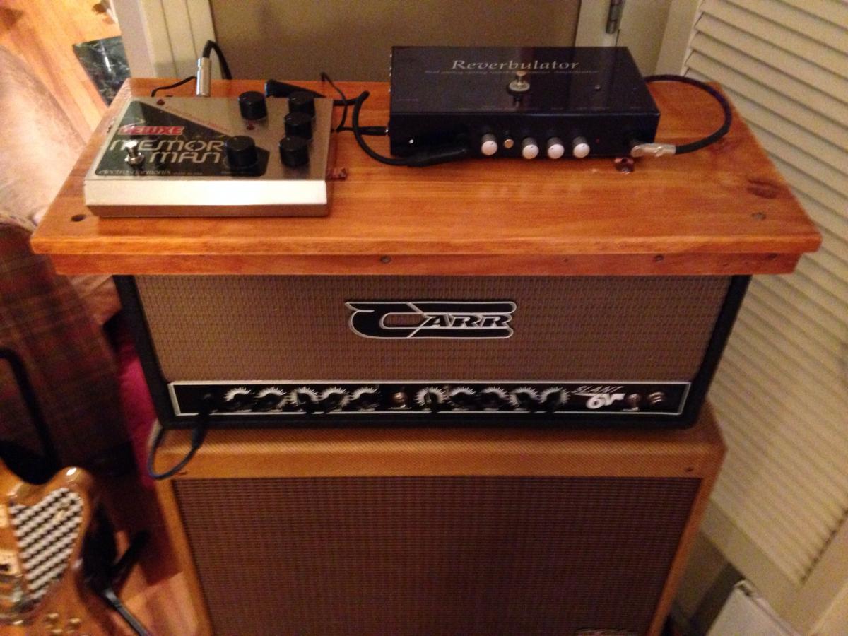

Here is the new set up. I using a Carr slant 6v with a 2x12 open back cab.
The cab is loaded with two 100 Watt weber fane copy's.

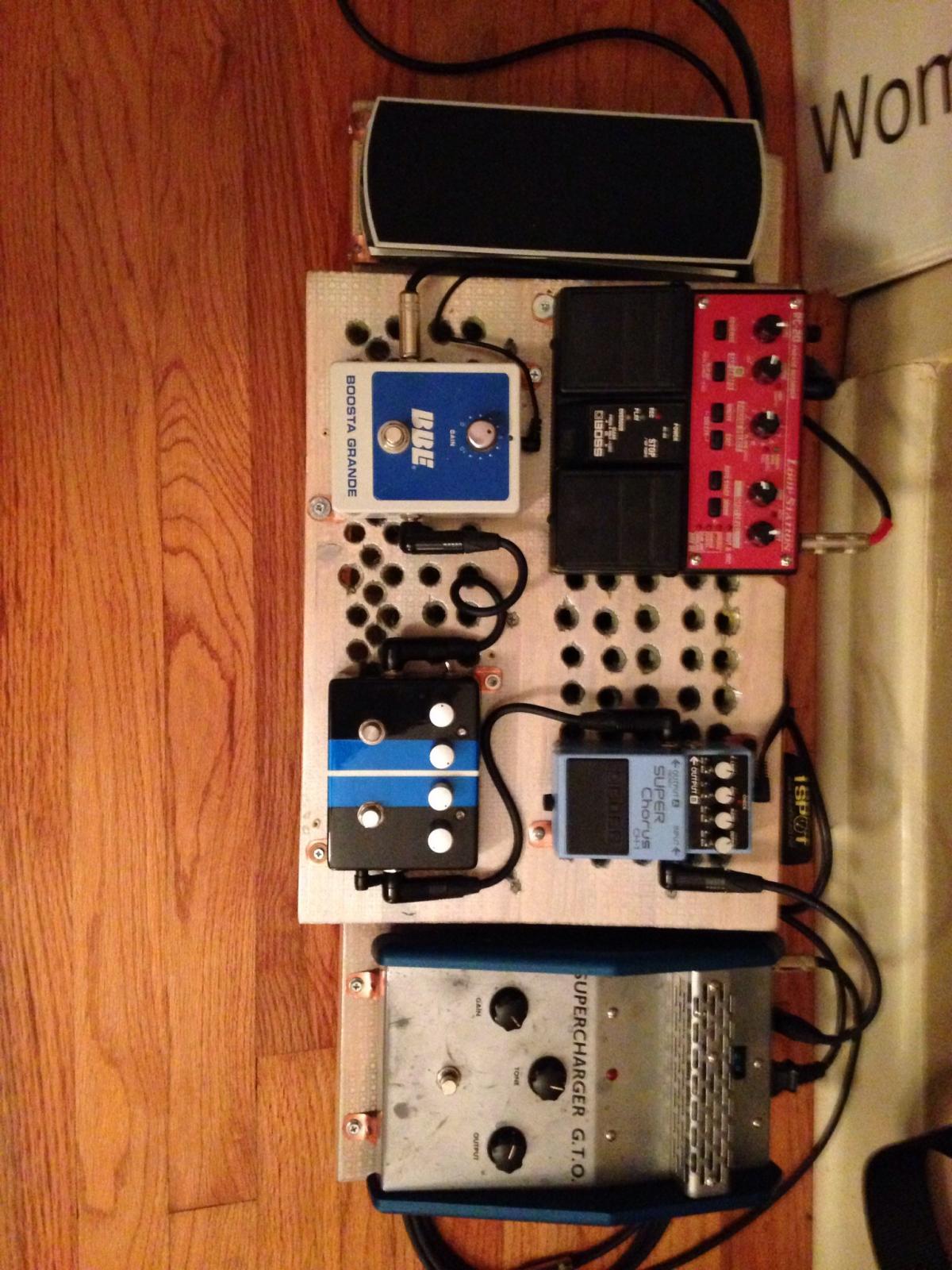

I'm really digging the sound. I just set up two pedal boards. The first sits on top of the amp head and is run through the fx loop. It has my time based pedals, a EH deluxe memory man and a Demeter reverb unit. The second is a floor pedal board Amp< Volume pedal< loop station< clean boost< distortion< chorus < overdrive< guitar. So far it works great however I may move the loop station.

I would change the routing of your pedals before you change anything.
First, put the reverb after the delay to smooth the decays of the memory man! No way would I feed the MM with a splashy verb signal!!!
(I can see the output of the Demeter going into the MM)
Put the chorus in with the time base FX, in front on the Delay!
If you have to have three dirt/OD/boost pedals but a Boss TU2 or TU3 pedal between the volume and the dirt/OD/pedals, the buffer
circuit will help retain your highs.
DUMP THE LOOPER! please see my posts about loopers in the looper threads:)
And now for another observation... I would knock a few of those OD's off of the board and have an amp channel switch on the board.
You paid serious money for a boutique amp and then degrade the tone with those OD's, maybe just get one pedal to push the dirty
tone/dirt of the 6V over the top. The amps are pretty righteous sounding and too many pedals in front of the inputs or in the loop are
going to wreak havoc on the tone, unless the pedal board has loops to bring the FX in and out (see KUZ's board for a good example
of the loop setup). All of this of course is IMNSHO!!!
Rockabilly, thanks for the ideas. I tried switching the reverb and the memory man around and I like it better in that order + I don't ever use them at the same time. The clean channel has it own reverb so I really only use it on the gain side. As for the looper? I use it to practice, I really like being able to lay down the rhythm with the tempo feature and then practice my fills and lead over it, it also lets me practice singing the songs w/o having to play. As for now I have it wired so that I can bipass it fully for band practice and shows. It does require physically taking it out of the chain though. I guess it's easy enough to change the leads, still it would be nice it it had a bypass built in. As for giving up my dirt pedals, never! They may sound the same to everyone else, but to me they are very different animals, there is no real way to describe the soldano pedal, it is fantastic, especially through a good chimie clean channel. And the dementer is a fat boost/overdrive, the fat boost is stellar with p90 love it when I play the 575.
