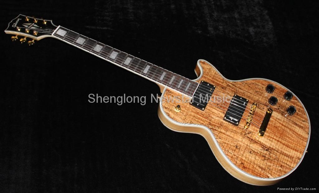

PacerX Posted November 30, 2013 Posted November 30, 2013 So, for my graduation from pharmacy school in May, I was going to celebrate with a built-to-my-spec H-157. The specs should go pretty much like this: 1) 1.75" wide at the nut... or as wide as they can go. 2) As flat a fretboard radius as I can get. 3) Seymour Duncan JB in the bridge (covered). 4) Seymour Duncan Jazz in the neck (covered). 5) The heavier, the better. No weight relief. 6) Medium frets. 7) Non-roller bridge. 8) Gold hardware. 9) Abalone trapezoid inlays. 10) Natural finish. 11) Triple binding w/ headstock binding. And... a spalted maple top... As long as it still sounds like maple (which I think it would, but don't know for sure...). Very similar to this guitar: Has anyone ever seen a spalted top on a Heritage, or does anyone have a Les Paul type guitar with a spalted top and can talk about if there's any tonal difference?
skydog52 Posted November 30, 2013 Posted November 30, 2013 I have asked and got a No on spalted maple. Those are great specs on your build and congratulations on your graduation!
davesultra Posted November 30, 2013 Posted November 30, 2013 I as well have heard that "H" will not do spalted maple tops.
PacerX Posted November 30, 2013 Author Posted November 30, 2013 I as well have heard that "H" will not do spalted maple tops. Hmmmm.... Well, maybe I'll just have to struggle through with a banging flamed top. I've done a little bit of research, and it seems that spalted tops need LOTS of ancillary work.... That being said, I wonder if there's something different that can be done. Birdseye? Burled? Flamed + quilted?

JackBaruth Posted December 2, 2013 Posted December 2, 2013 This is what I know from talking to a variety of luthiers about spalted maple. It's soft and "buttery" when it's harvested. So unlike other woods, it has to be "fixed" or hardened into workable material. There are a variety of ways that it can be done but most of the time the solution is, apparently, to soak it in glue, which crystallizes and "sets" the wood. At that point you can treat it like other woods. If you're one of the people who believes that tone in electric instruments is related to the wood choice, then you have to consider the fact that you are assembling your guitar with a pretty heavily crystalline material. In other words, the "wood" isn't going to give you the tone. It's the glue that will do it. I'd think long and hard about getting any carved-top guitar with spalted maple.
