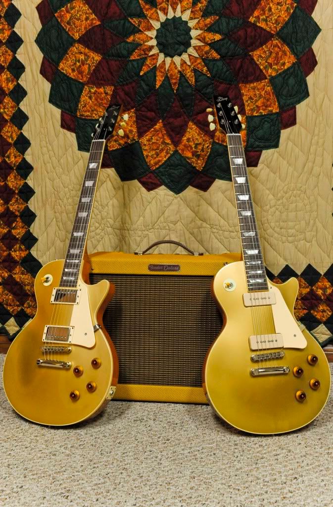

Kuz Posted December 9, 2013 Posted December 9, 2013 DB congrats on your new guitar, I'm a sucker for a Goldtop and that one has a nice dish. And I would go with a pickguard if you plan on gigging that big bad rocking machine. But I would seriously reconsider reflowing the solder joints on the back of those pots, they look iffy to me and could lead to extra noise, signal loss, and perhaps a failure down the line. The solder joints should be shiney (no greyish stuff), and when completed the excess flux should be wiped off with some isopropyl alcohol! I'm sure the amp builder guys (H, Slider, Mav212), out there would concur with me!!!!! I concur with Daniel about the weak solder joints. Also you definitely Have the older inferior pots. I finally got around to replacing my old 2005 pots in my GT 150 P90 with CTS super pots from RS Guitarworks and the taper is SO much better and clearer. I also can't tell if you have 50s wiring. I don't think you do. With 50s wiring the cap and the selector switch wire are soldered to the middle lug on the volume pot and the cap goes to the bottom lug on the tone knob. The hot pickup wire should be the only wire going to the bottom lug on the volume knob. If you do nothing else DB, you should convert the modern wiring that Heritage ships out to 50s wiring so you can turn your volume knobs past 8.5.

rockabilly69 Posted December 10, 2013 Posted December 10, 2013 I concur with Daniel about the weak solder joints. Also you definitely Have the older inferior pots. I finally got around to replacing my old 2005 pots in my GT 150 P90 with CTS super pots from RS Guitarworks and the taper is SO much better and clearer. I also can't tell if you have 50s wiring. I don't think you do. With 50s wiring the cap and the selector switch wire are soldered to the middle lug on the volume pot and the cap goes to the bottom lug on the tone knob. The hot pickup wire should be the only wire going to the bottom lug on the volume knob. If you do nothing else DB, you should convert the modern wiring that Heritage ships out to 50s wiring so you can turn your volume knobs past 8.5. Agree on the 50's wiring, especially with humbuckers! I also love RS superpots for their silky feel, although some feel they are little too stiff, I think they break in nicely! Another sleeper and a less costly alternative is the DiMarzio custom taper CTS short shaft 500k pot. They are very high quality, extremely fair priced, and also made by CTS. Also I love Jensen PIO caps (.015 for the neck, .022 for the bridge), these with 50's wiring, and good pots would really work great in the Goldtop! http://www.musiciansfriend.com/accessories/dimarzio-500k-custom-taper-split-shaft-pot
Guest HRB853370 Posted December 10, 2013 Posted December 10, 2013 Agree on the 50's wiring, especially with humbuckers! I also love RS superpots for their silky feel, although some feel they are little too stiff, I think they break in nicely! Another sleeper and a less costly alternative is the DiMarzio custom taper CTS short shaft 500k pot. They are very high quality, extremely fair priced, and also made by CTS. Also I love Jensen PIO caps (.015 for the neck, .022 for the bridge), these with 50's wiring, and good pots would really work great in the Goldtop! http://www.musiciansfriend.com/accessories/dimarzio-500k-custom-taper-split-shaft-pot We will have to disagree on the pickguard for DB's GT RB! IMO goldtops just look so cool sans pickguard. Take a look at Duanes.......

DetroitBlues Posted December 10, 2013 Author Posted December 10, 2013 I'll probably get the wiring changed. I've given up on doing it myself though... I found a decent shop that does a great job for not too much. As far as pickguards, I think they look nice on gold tops. Especially the Gibson design.
