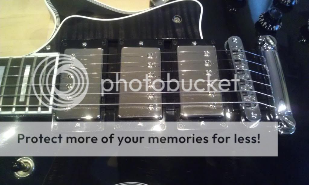

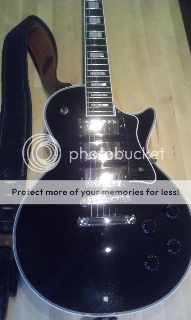

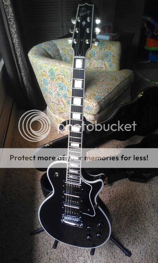

Redsand Posted December 18, 2013 Posted December 18, 2013 So I quenched my thirst for a solid bodied Heritage a few months back with this wonderfully preserved H-157! She sounds great, plays great and looks killer but here comes the but….. While I have really enjoyed getting to know her, the guitar's 3 pickup configuration has been really difficult to adjust to, I'm a 60/40 fingerstyle/hybrid player which awkwardly places my fingertips directly onto the middle pickup when I play without a pick. I've tried lowering the middle pickup but wasn't crazy about the results, do I dare compromise the integrity of this guitar by removing the pickup all together or is that just crazy talk? What are some realistic options here?
PunkKitty Posted December 18, 2013 Posted December 18, 2013 I don't like having more than 2 pickups on a guitar. But if you don't have a pickup there, it will leave a gaping hole.
rockabilly69 Posted December 18, 2013 Posted December 18, 2013 When you lower the middle pickup raise the polepieces slightly, and lower the neck and bridge pickup a bit too so they they balance. And add a little gain on the amp end. I have two, 3 pickup guitars, and I've gotten used to them when I thought I wouldn't.
Number8 Posted December 18, 2013 Posted December 18, 2013 I don't know what your options are...but that thing is bad a$$.

Yooper Posted December 18, 2013 Posted December 18, 2013 Interesting problem. Can you play over the fingerboard? Maybe switching off the pickup you play over would help. This still leaves you three position options. I can see playing a Strat with 3 narrower single coil pickups would be much easier.

Redsand Posted December 18, 2013 Author Posted December 18, 2013 When you lower the middle pickup raise the polepieces slightly, and lower the neck and bridge pickup a bit too so they they balance. And add a little gain on the amp end. I have two, 3 pickup guitars, and I've gotten used to them when I thought I wouldn't. Yeah, I definitely need to do some more tinkering with this one, I'll get her on the bench this weekend and try out your suggestion….thanks! Interesting problem. Can you play over the fingerboard? Maybe switching off the pickup you play over would help. This still leaves you three position options. I can see playing a Strat with 3 narrower single coil pickups would be much easier. Hey Dave! I actually gave some brain cells to the notion of installing a single coil in that middle position (a la Alvin Lee) to free up some space, unfortunately, I'm not so sure playing over the fingerboard would work for me.

HANGAR18 Posted December 19, 2013 Posted December 19, 2013 I don't have anything important to add. I just wanted to say that guitar looks incredibly awesome!

bolero Posted December 19, 2013 Posted December 19, 2013 that is a beauty allright, you rarely see a 3 pup H157!!
shook494 Posted December 19, 2013 Posted December 19, 2013 That 157 is awesome looking! Just wanted to say that.
Hfan Posted December 19, 2013 Posted December 19, 2013 There are very low pick up rings available, typically used for the neck position, some are lower than others, maybe that would buy some room? I suppose the radical fix would be to remove it and have a good luthier fill the hole and re finish the area..it is flat black..but with the cost of that, I would sell it and find a two pick up model. Would be kind of a shame to molest it like that.
Gitfiddler Posted December 19, 2013 Posted December 19, 2013 3 P'up 157's rule! Yes, the middle pickup can take a bit to get used to it. But over time you will. Muscle memory will kick in if you stick to playing that guitar and no others for about a week. Make the adjustments to the pickups as mentioned above and you'll get great tones from that axe. How is your 3-way switch wired?

Redsand Posted December 19, 2013 Author Posted December 19, 2013 3 P'up 157's rule! Yes, the middle pickup can take a bit to get used to it. But over time you will. Muscle memory will kick in if you stick to playing that guitar and no others for about a week. Make the adjustments to the pickups as mentioned above and you'll get great tones from that axe. How is your 3-way switch wired? Once upon a time Brent actually owned this guitar and installed a 6 way toggle, works great!
