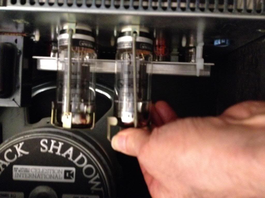

TalismanRich Posted December 19, 2013 Posted December 19, 2013 I found this picture of one. You could probably use a straight piece of metal as well as the aluminum tube.
GuitArtMan Posted December 19, 2013 Posted December 19, 2013 Is it just me or is the one in the pic above not going to line up well?
GuitArtMan Posted December 19, 2013 Posted December 19, 2013 You can get tube dampers on eBay (and other places). Not quite the same thing but may do the trick. Of course, a new set of tubes might be what's in order here. http://www.ebay.com/sch/i.html?_trksid=p2050601.m570.l1311.R1.TR2.TRC1.A0.Xtube+damper&_nkw=tube+dampers&_sacat=0&_from=R40
TalismanRich Posted December 19, 2013 Posted December 19, 2013 Is it just me or is the one in the pic above not going to line up well? I think it's just a matter of perspective. The tamer is pulled out a bit, away from the tubes. Mine line up perfectly well. I still kept the wire holders on there as well. The rubber rings might work as well. The rings won't help keep the tubes tight in the sockets like the TT will. As for needing new tubes, it seems to me that EL84s are more microphonic to me than 6L6s and EL34s. It might vary by brand but the ones in my DSL401 had some ring as well. Maybe its just the closeness to the speaker in a combo amp.
