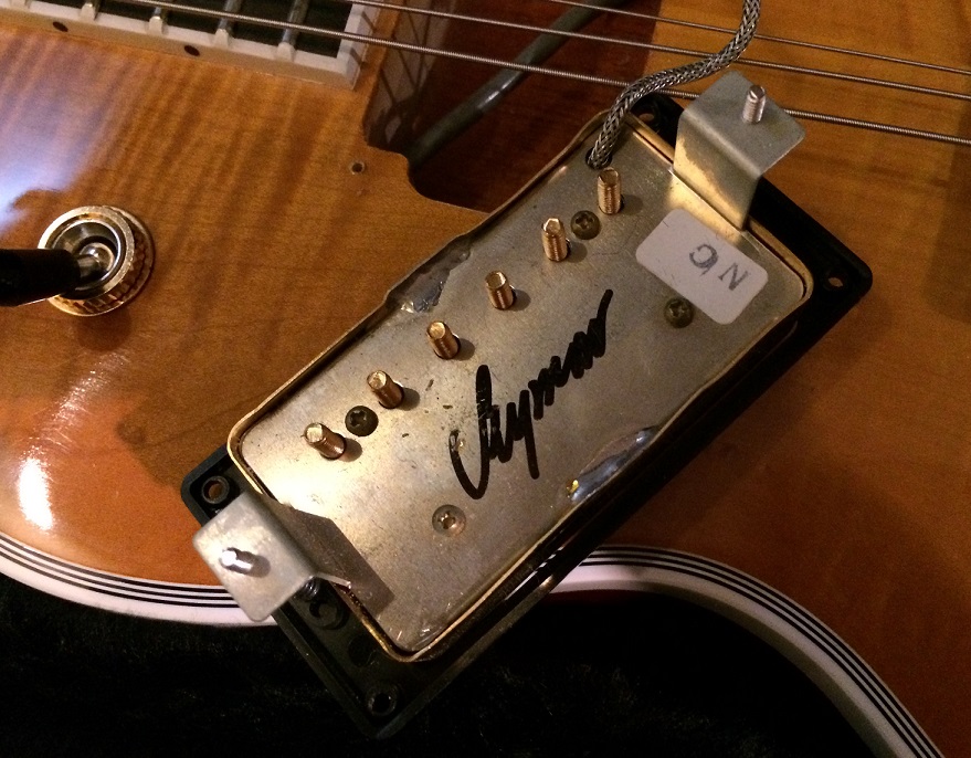

thedomedcity Posted January 24, 2014 Posted January 24, 2014 Anyone know what is inside the two yellow cylinders electrically connected between the volume and tone controls? I am assuming it is a capacitor of some value and it looks to be covered in a yellow plastic cylinder and filled with Elmers glue. Also, which pickups did they use in this model? Sounds fantastic. thank you in advance for any insight.

tulk1 Posted January 24, 2014 Posted January 24, 2014 How do you know they "appear" to be filled with Elmer's? Pickups were mostly likely Schallers. If you have two adjustment screws per side, then yep, Schallers.

PunkKitty Posted January 24, 2014 Posted January 24, 2014 Pictures would help us identify the pickups. I suspect that they are Schallers. The yellow tubes are most likely capacitors. Again, pictures would help.

thedomedcity Posted January 24, 2014 Author Posted January 24, 2014 PUPS are single screw on each side not double.
PunkKitty Posted January 24, 2014 Posted January 24, 2014 If they are factory pickups my guess is that they are Seymour Duncans of some type. There might be a sticker on the bottom of the pickups to identify them. The caps look like ordinary .022mfd caps.
thedomedcity Posted January 24, 2014 Author Posted January 24, 2014 Thanks. Next time I take the strings off, I will look under the hood.

barrymclark Posted January 25, 2014 Posted January 25, 2014 If they are factory pickups my guess is that they are Seymour Duncans of some type. There might be a sticker on the bottom of the pickups to identify them. The caps look like ordinary .022mfd caps. Doubtful they are factory but may well be. The tip off for me is the pickup rings are the Schaller type. BUT the pickups could be Schaller and the 4 adjustment screws were just reduced to the traditional 2. Probably have to lift one of the pickups to truly know. Gotta say. ... I'm leaning towards them being Schaller as the pole spacing in the neck pickup seems to be right for that. If that's the case, they would likely be factory but with the screw mod. Sent from my SCH-I605 using Tapatalk
thedomedcity Posted March 7, 2014 Author Posted March 7, 2014 Mystery solved! PUPS have Seymour signature on them. btw- this is an original guitar shipped to me from the factory and unaltered.
SouthpawGuy Posted March 7, 2014 Posted March 7, 2014 Mystery solved! PUPS have Seymour signature on them. btw- this is an original guitar shipped to me from the factory and unaltered. If I remember correctly the lefty 140 pictured in the gallery has Seth Lovers installed
