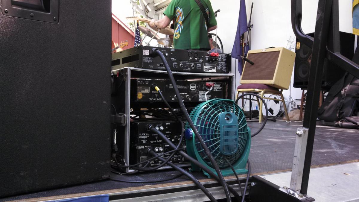

HANGAR18 Posted April 4, 2014 Posted April 4, 2014 Actually, I wasn't. I know two people who had Carvins that had a voltage spike and caught their speaker cabs on fire. So I guess that wouldn't be the fault of the Carvins. Regulated power is important. I saw a show last year where the guys had a fan on the PA amps. I assume that is either normal or at least just a good idea. (See photo.)
CJTopes Posted April 4, 2014 Posted April 4, 2014 Thats not uncommon to have a fan on the power amps for a PA.... My PA head has a built in fan....
tbonesullivan Posted April 8, 2014 Posted April 8, 2014 So I guess that wouldn't be the fault of the Carvins. Regulated power is important. I saw a show last year where the guys had a fan on the PA amps. I assume that is either normal or at least just a good idea. (See photo.) A lot of power amps have built in fans. Both of my bass heads have built in fans that go faster if the temp goes up, and my power amp does as well. If you look inside the power amp, it's a GIANT HEATSINK. before the fan. There are a good amount of tube amplifiers that also have fans to help keep the chassis cool. If you run your amp at an angle, it's often a good idea to blow a fan across the back from a distance to prevent heat from getting trapped in there. This is also why some combo amps have vents on the top.
