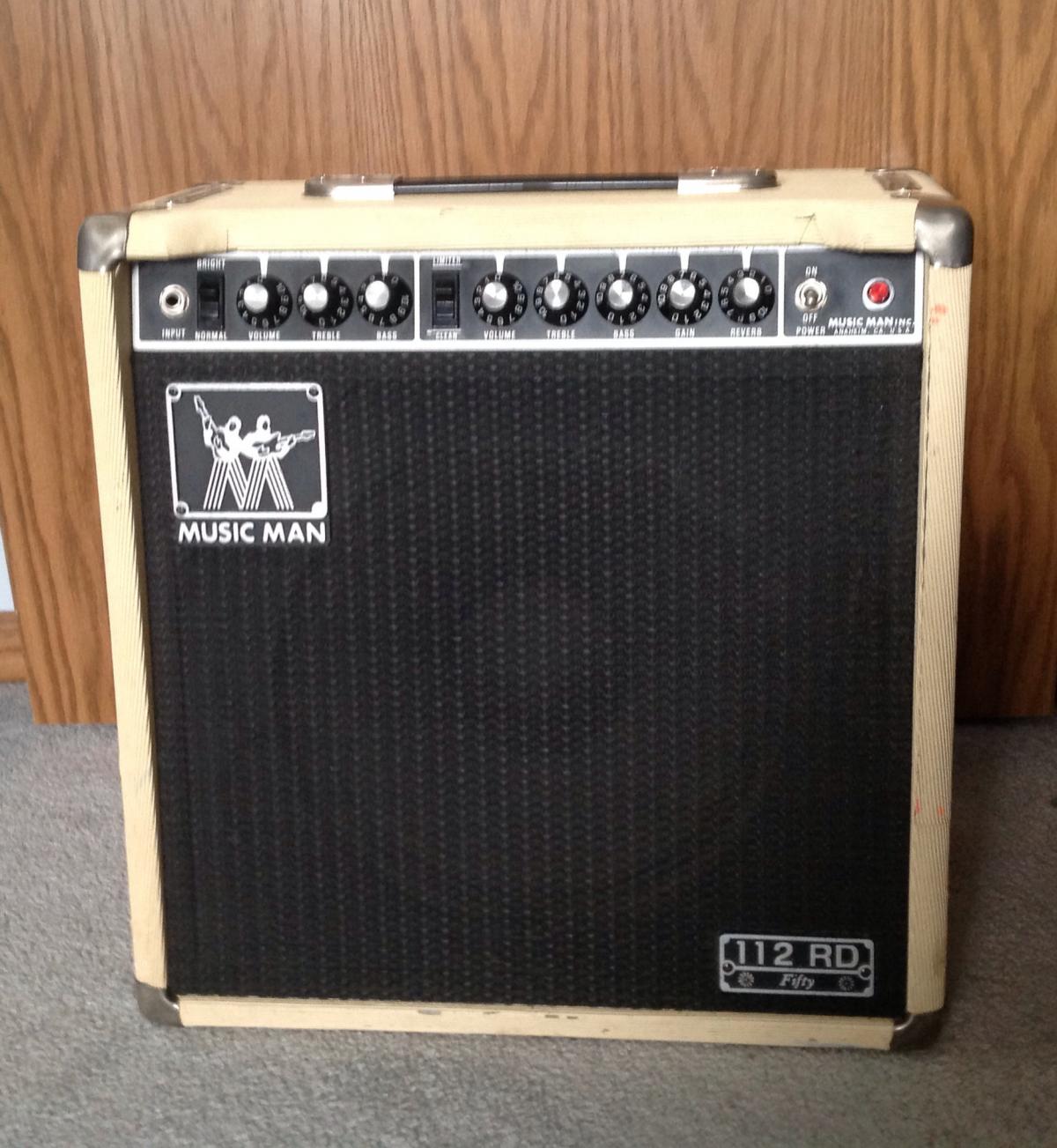

Yooper Posted March 20, 2014 Posted March 20, 2014 Compact but freaking heavy! Yeah, DB, MMs are heavy, but not as heavy as a Boogie of similar power. I'm still on my quest for a good gigging tube amp under 45 pounds. Spinal disc degeneration sucks. Warren Haynes's guitar tech Brian Farmer uses a Musicman RD-65 amp like mine.
Yooper Posted March 21, 2014 Posted March 21, 2014 That's one fine, sparkling gem of an amp. It will nicely do what you need it to do.

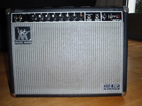

bolero Posted March 21, 2014 Author Posted March 21, 2014 mine is a 112 RP model...here is one: mine is in considerably worse than mint shape actually one I replace the grillcloth it will look pretty good the trem is excellent...goes from Fender all the way into Moog territory!! pretty neat
Yooper Posted March 21, 2014 Posted March 21, 2014 Looks like we have a Music Man amp wing of the HOC. I've had my 112-RD 65 since 1979. Zero problems.
slider313 Posted March 21, 2014 Posted March 21, 2014 mine is a 112 RP model...here is one: mine is in considerably worse than mint shape actually one I replace the grillcloth it will look pretty good the trem is excellent...goes from Fender all the way into Moog territory!! pretty neat The 112 RP has reverb and a phase shifter, not tremolo. I guess that's why it gets you into "Moog territory!
bolero Posted March 22, 2014 Author Posted March 22, 2014 haha....good point I guess it would explain the "P" I assumed it was just a souped up trem circuit they renamed to avoid copyright, or add hype
