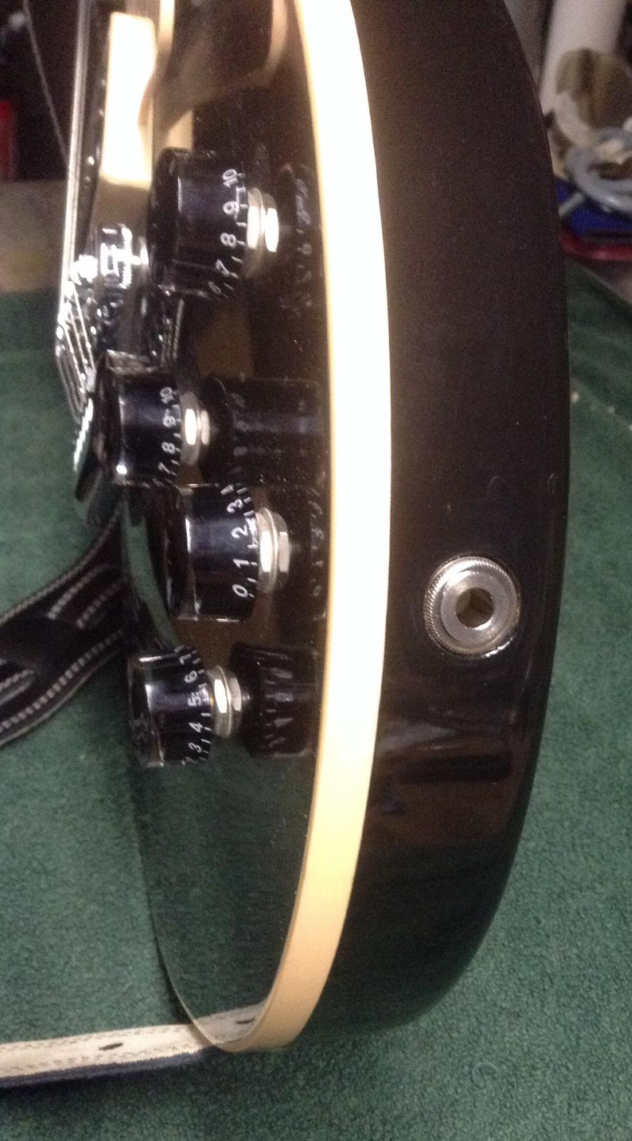

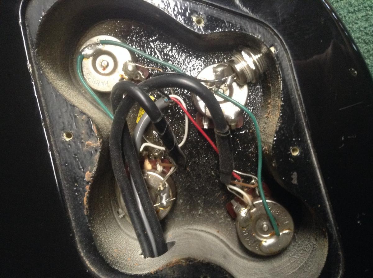

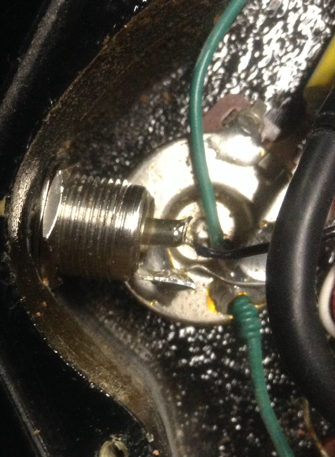

baggins Posted March 23, 2014 Author Posted March 23, 2014 Disclaimer: my friend did all the soldering, I only removed and replaced the jack. -credit where credit is due, right? He also cut the strain relief and drilled a small hole in it for a more secure connection. This is the new jack installed.
baggins Posted March 23, 2014 Author Posted March 23, 2014 photo was a little askew, so sorry for the extra post above. Anyhow, thanks for the advice. I have no idea how many H150Ps exist, but that's how the process goes.
