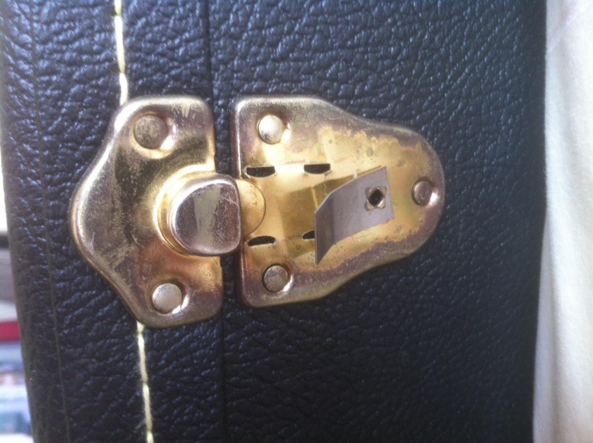

AlanL Posted April 3, 2014 Posted April 3, 2014 The Heritage case for my 1999 Super Eagle has rusted brass latches, and two have broken. Does the manufacturer work on these is I should I just find a reputable luggage repair shop?
Genericmusic Posted April 3, 2014 Posted April 3, 2014 Luggage repair shop will work or you can just go to a hardware store purchase a same size latch or latches and do it yourself.
houndhome Posted April 3, 2014 Posted April 3, 2014 The case on my 1998 Super Eagle has had one go in the same way.
pressure Posted April 4, 2014 Posted April 4, 2014 Brass doesn't rust but the steel springs do. Put lube on the springs and they will be smoother and protected from future rust.
Spectrum13 Posted April 4, 2014 Posted April 4, 2014 I have been fixing to post something about "case care" what to do and how often. Good tip on the lube Richard.
