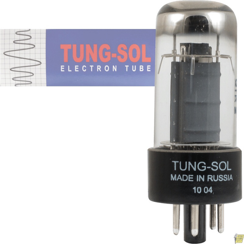

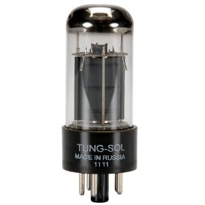

ScottNaylor Posted April 7, 2014 Posted April 7, 2014 Just one note on the new Tung-Sol's, I bought a dozen of them when the current style came out two or three years ago. They were wonderful tubes, easily the best new manufacture out there. Used them in 5e3s, Swarts, DRRI, and Reinhardt. Only some of the better NOS beat them out sonically. Quiet and low micros too. Six weeks ago bought 6 from the same supplier, noticed the construction was different. The two I put in a Swart AST to replace the previous ones couldn't handle the plate voltage and quit. One of the remaining four with easy duty in a Richter (330 plate voltage) went micro phonic to an unusable extent immediately, and a second just plain quit. Perhaps most telling, a tube supplier I respect greatly no longer sells Tung-Sol 6v6's after being a big fan of their previous effort. As always, YMMV. And, NOS tubes are still the best long term and ultimate sonic value out there for 6v6's.😊

slider313 Posted April 9, 2014 Posted April 9, 2014 On 4/7/2014 at 8:40 PM, ScottNaylor said: Six weeks ago bought 6 from the same supplier, noticed the construction was different. The two I put in a Swart AST to replace the previous ones couldn't handle the plate voltage and quit. Can you explain the difference in the construction or show a photo of the earlier build compared to the new ones you recently purchased?
ScottNaylor Posted April 9, 2014 Posted April 9, 2014 Here are pix already on the 'net. They look more like the Electro Harmonix tubes to me now. Would be interesting to know if there are any changes obscured by the plates as well.

slider313 Posted April 9, 2014 Posted April 9, 2014 On 4/9/2014 at 5:54 AM, ScottNaylor said: Here are pix already on the 'net. They look more like the Electro Harmonix tubes to me now. Would be interesting to know if there are any changes obscured by the plates as well. The spacers, plates and getter supports look the same, from what I can tell, but it looks like the getters are those "flying saucer" type instead of the halo getter. I haven't seen the newer production 6V6's, in the photo, but it wouldn't surprise me if they changed them for the worse. It seems to be the order of the day with many products. A company will put out a great product for a couple of years and change to cheaper materials and lessen the product; after building up a good customer base.
