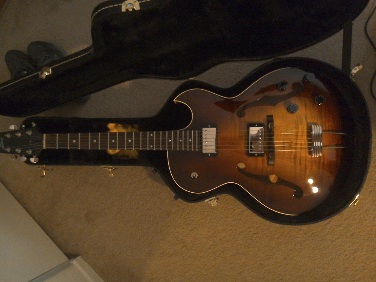

sec6 Posted April 9, 2014 Posted April 9, 2014 Just picked up new Heritage yesterday. I adjusted the bridge and everything is well intonated except for the B string which is overcompensated. Any advice would be appreciated. I have 11 flats on it. Thanks, Steve

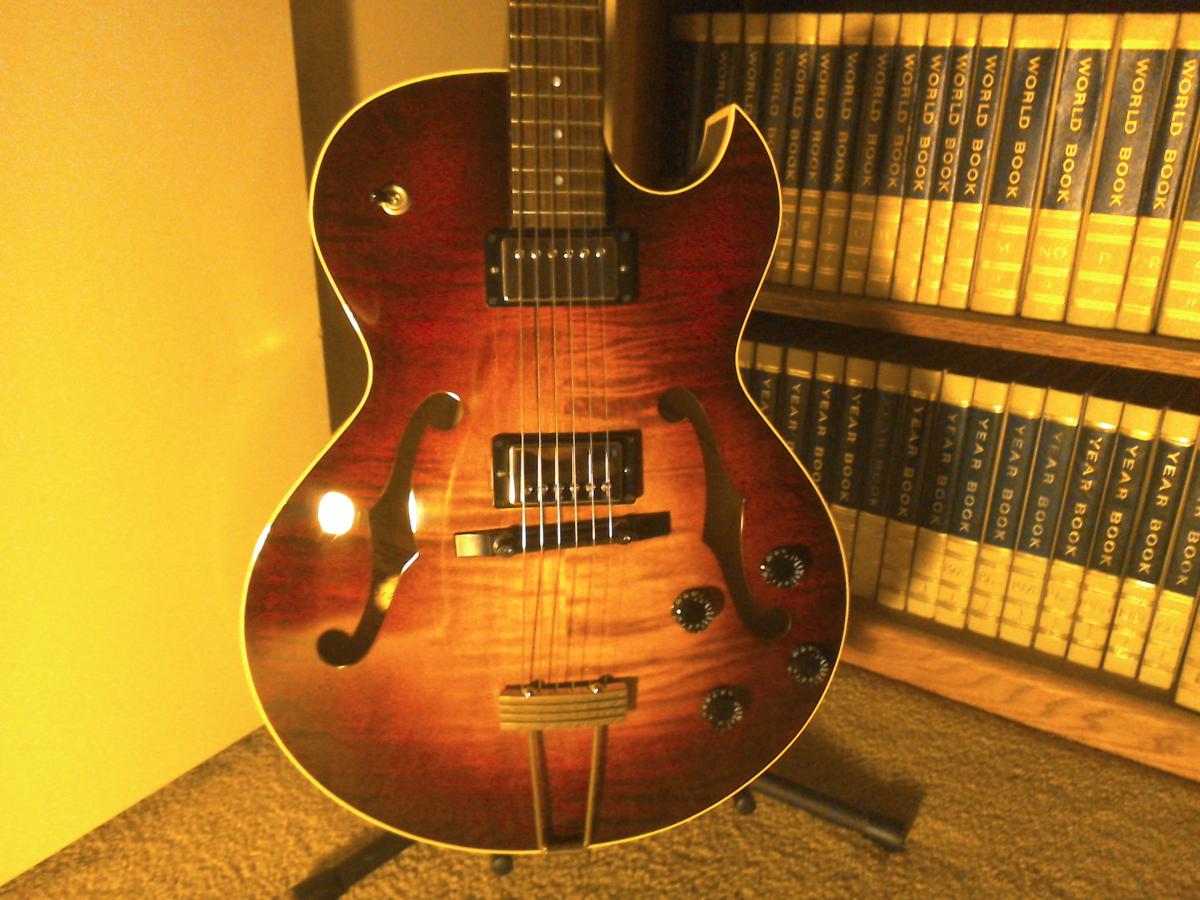

peterbright Posted April 9, 2014 Posted April 9, 2014 To me...the bridge appears to be too far forward.
sec6 Posted April 9, 2014 Author Posted April 9, 2014 The B is flat at the 12th fret. Everything else is in tune. It is definitely not too close towards the neck. Anybody else have this problem with the rosewood compensated bridges where the B saddle is too far back. How do I fix this issue?

yoslate Posted April 10, 2014 Posted April 10, 2014 To me...the bridge appears to be too far forward. I have to agree. As a rule of thumb, the bridge should line up with the inward facing "points" (called a "nick") at the widest dimension of the "f" hole. I think that's where you'll find it if you set the bridge at exactly the same distance from the twelfth fret as the twelfth fret is from the nut. At that point, you may have to cant the bridge slightly for better intonation on either the bass or the treble side.
sec6 Posted April 10, 2014 Author Posted April 10, 2014 I solved the problem. Just swapped bridges with my Godin. The Graphtech Tusq bridge intonates perfectly for each string.
