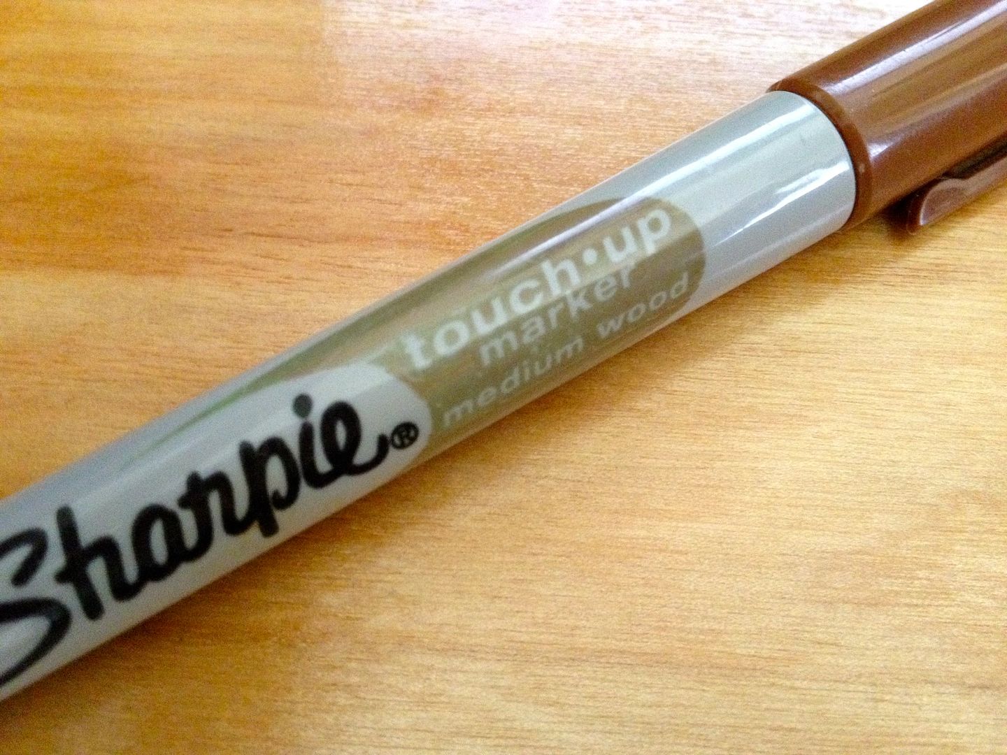

2bornot2bop Posted April 12, 2014 Posted April 12, 2014 I had one of those with the top scraping disease. After I sold the archtop I later learned that's an EZ fix with a Sharpie 'touch up marker'...Lem, archtop's main repair guy, turned me on to them...they come in different shades...they're a very quick fix...cheap too.
