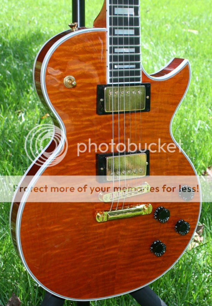

Millennium Maestro Posted July 2, 2014 Posted July 2, 2014 I have both, if you are asking just about f holes or no f holes I will start by saying NO holes if you are more intent on Amplified/electric. Just because it will respond my towards the Solid body in characteristic. For me if I am on stage I prefer the solid top, strictly out of aesthetics. I play alot acoustically and at low volumes while the wife sleeps, Love the f holes there. YES the f holes add a touch of elegance, not so much when I am performing Rage against the machine, Chevelle, AIC etc. Wrong vibe but still better than PINK... LOL JK Kuz. - My favorite Millie... 2000 Ltd Ed. w f holes, I am sure TailmanRich would agree. - The Millie I would most like to own Tulks OSB DC Guy ps. You are always welcome to call and bounce ideas off me!

Spectrum13 Posted July 3, 2014 Posted July 3, 2014 Ive had Millies with and without f holes. Here is how that goes. Some of the original Millies were arched top and back, like the sample tube man posted. Those were never actual production models, according to Marv. Laminate top and back. Semi hollow. You change pots, etc the usual way ... thru the holes. Marv told me that at the time of those models they tried a few with access plates, but the plates were so large they interfered with the integrity of the back. The production models became flat back, solid top and back. Those, of course have access plates. You wont find an arch back model with an access plate. Nor without f holes. You may find a semi-solid model with or without f holes. But not without an access plate. That's how I recall it all. And then we have Pressure's solid spruce top without f holes or a black plate.
pressure Posted July 3, 2014 Posted July 3, 2014 No f-holes, no back-plate = pain to change electric parts or at least thats what Chip at the Music Gallery said after he replaced the electrics with a full RS guitarworks kit.
