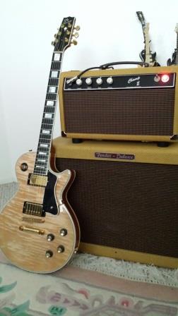

Gitfiddler Posted July 6, 2014 Posted July 6, 2014 In my seemingly never ending search for better tone from tiny amps, I swapped out a perfectly good matched pair of Groove Tube 6V6's out of my Champ II Tweed head. In their place I loaded a matched set of JJ 6V6 'S' tubes I had from another amp project. The JJ's are supposed to be robust tubes that can handle higher plate voltages, so I expected strong performance. As soon as the JJ's were loaded and the amp turned back on, the amp made a strange low frequency pop...then died!! Nothing! No light. No sound. Nothing! OMG! Did I blow a transformer from my favorite little Champ beast! Or worse! Nope, just a blown fuse, thankfully. Well, to test that theory, I inserted that same set of JJ's in my other Champ II. The fuse blew immediately. Fortunately, I had a set of 1-amp slo blo fuses and replaced them in both amps. I also re-installed the original Groove Tube 6V6 tubes. Now the amp sounds fine, but what happened? Why would the same tube type blow fuses?
