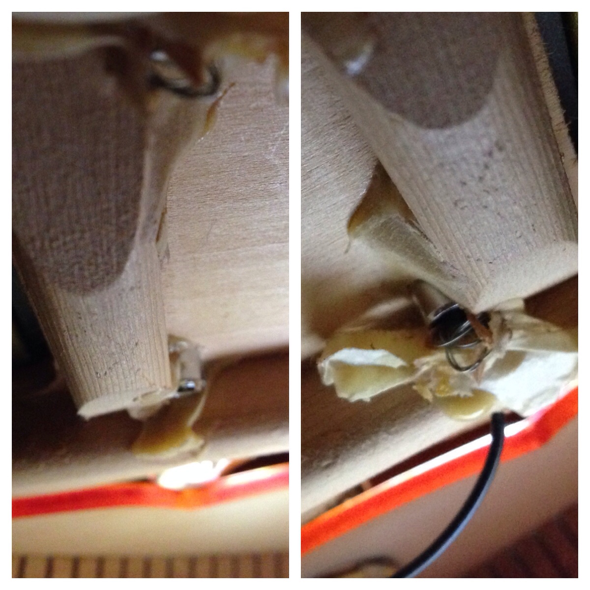

Nosignal Posted July 10, 2014 Author Posted July 10, 2014 I talked to Ren this morning. He seemed to think that the bushing wasn't seated properly. He told me to try and take the strings off and tap it in a bit. I'm not quite sure if that's the problem. I've taken a couple pictures of the inside where both posts are seated. Not sure if everything looks in order or not.

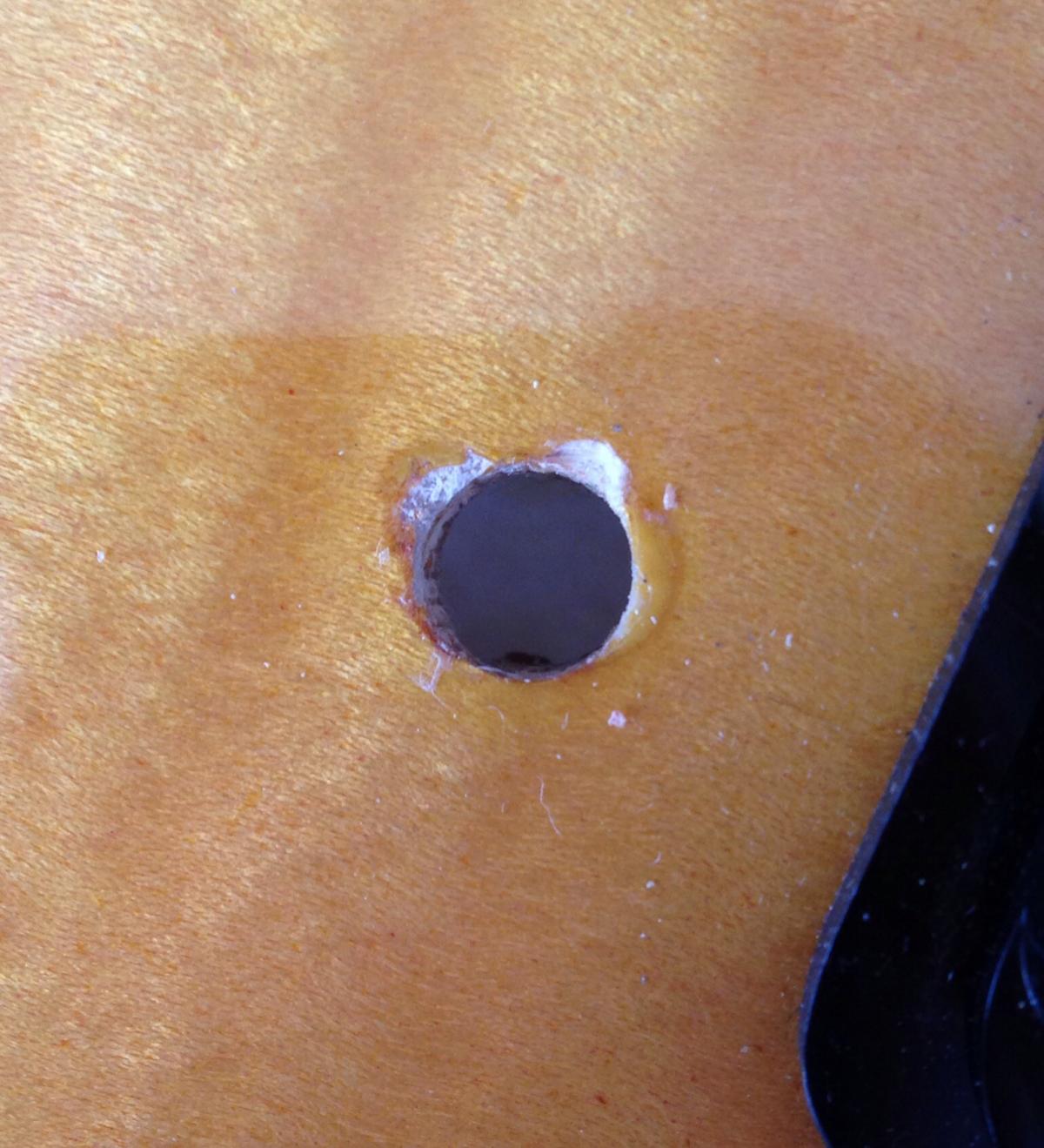

Nosignal Posted July 10, 2014 Author Posted July 10, 2014 So I took the strings off and found that the bushing is in fact all the way seated. Though I was able to take the post out with my fingers. I took a picture of the bushing hole. I'm guessing that this is just the way it's supposed to be.
Hfan Posted July 10, 2014 Posted July 10, 2014 If you remove the stud, does it go in crooked the whole way? I'd guess yes. Couldn't see how it would start straight and then cock to an angle like that. The proper way to fix that if it's drilled crooked (coming from an amateur tinkerer FWIW etc) is to fill the hole with a glued in dowl and re drill. If it starts straight somehow it may be an easier fix. Once it is all the way in it has no wobble? It has a tight fit at that angle? That would bug me.

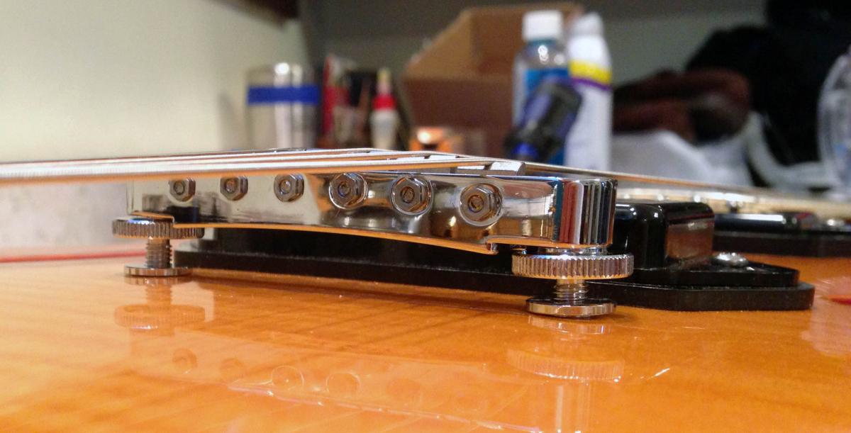

Nosignal Posted July 11, 2014 Author Posted July 11, 2014 Upon looking more, I think the issue is that the top of the guitar is too curved to let both bushings set flush on the top. I'm not sure if this is how it's supposed to be, but it looks like there's not much else I can do. There's no wiggle in either bushing, they both fit tight. I do have a valid warranty. But I'd hate to ship this to michigan and wait for it to come back and still have the same problem. I took a picture to help illustrate the curve of the top a bit more (at least that's what I tried to do).

HANGAR18 Posted July 11, 2014 Posted July 11, 2014 After reviewing the information presented regarding the bridge, I am now of the opinion (fwiw) that the relationship between the upright posts and the actual bridge and the strings and the fretboard are more important than the stop tabs where the posts meet up with the curvature of the body. If the stop tabs sat flush witht he body, then the posts would be pointing in the wrong direction and the bridge wouldn't fit or be in the correct position either. If you had a flat top guitar body, then yes, the stop tabs ought to sit flush against the body. But because this is a curved, arched top we are talking about, then no, I don't see how it would be possible to have the stop tabs sit fluch with the surface of the body. (Just an opinion.)
Kuz Posted July 11, 2014 Posted July 11, 2014 On 7/11/2014 at 12:52 PM, HANGAR18 said: After reviewing the information presented regarding the bridge, I am now of the opinion (fwiw) that the relationship between the upright posts and the actual bridge and the strings and the fretboard are more important than the stop tabs where the posts meet up with the curvature of the body. If the stop tabs sat flush witht he body, then the posts would be pointing in the wrong direction and the bridge wouldn't fit or be in the correct position either. If you had a flat top guitar body, then yes, the stop tabs ought to sit flush against the body. But because this is a curved, arched top we are talking about, then no, I don't see how it would be possible to have the stop tabs sit fluch with the surface of the body. (Just an opinion.) I agree with this. I have some guitars ( other brands) where the arched top give the same picture as above. If it is rock solid seated (doesn't move or wobble) then I would leave it alone. Just my .02
Gitfiddler Posted July 11, 2014 Posted July 11, 2014 On 7/11/2014 at 12:52 PM, HANGAR18 said: After reviewing the information presented regarding the bridge, I am now of the opinion (fwiw) that the relationship between the upright posts and the actual bridge and the strings and the fretboard are more important than the stop tabs where the posts meet up with the curvature of the body. If the stop tabs sat flush witht he body, then the posts would be pointing in the wrong direction and the bridge wouldn't fit or be in the correct position either. If you had a flat top guitar body, then yes, the stop tabs ought to sit flush against the body. But because this is a curved, arched top we are talking about, then no, I don't see how it would be possible to have the stop tabs sit fluch with the surface of the body. (Just an opinion.) Kuz: "I agree with this. I have some guitars ( other brands) where the arched top give the same picture as above. If it is rock solid seated (doesn't move or wobble) then I would leave it alone. Just my .02" +2 Yep. Your last photo shows that the hardware is properly aligned, even though the guitar's top is slightly arched. I wouldn't be concerned with it unless there are playability or intonation issues. It looks stable.
