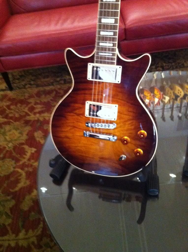

kidsmoke Posted July 18, 2014 Posted July 18, 2014 This guitar was available for sale at the HOC Winter muster. It was brand spanking new, built as spec'd by Chicago Music Exchange. Gorgeous guitar, with evidence of light checking at the pocket. It has greatly deteriorated since then (March)
kidsmoke Posted July 18, 2014 Posted July 18, 2014 I don't believe this is broken at all, having played it and looked at it closely at the time, (as did others here) I think its a failed neck joint that is separating as time goes by. Need to be re-set and refinished, and would be a fine guitar. It was for sale with a full warranty in March, from CME, the new owner probably could have purchased it and sent it back to Kzoo for repair at no cost. I dunno how that would work now. It's up for sale as a B-stock...so they're not saying its "good as new"
