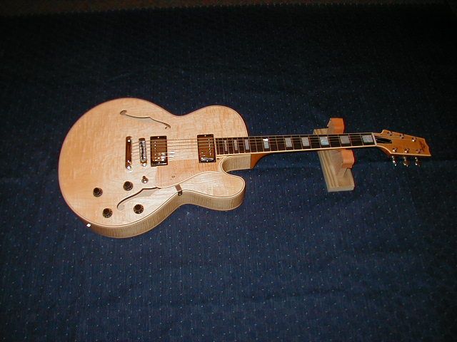

Stringman Posted September 9, 2014 Posted September 9, 2014 Well, just to jump in here on the H-576 model. I own a H-576 and most of what I read above is correcct. However the one big difference between the 576 and a 535 is that the center block on a 576 is ONLY attached to the top. The back is not attached to the center block. When I bought this guitar I was advised against this model in favor of the H-575 (I had already owned on of those) because the person said the 576 with it's non-attached cneter block would feed back more than the 575. I have not found this to be the case at all. My 576 has been modernized with: Seymour Duncan 59 pickups, a Gibson stop tail piece, and a Gibson ABR bridge with graphite saddles. It was set up and the pick up change was handled by Elderly Instruments in Lansing, MI. They do great work. A major positive for me of the 576 VS. the 575 is that the input jack is not a part of the tailpiece/strap button. The jack is on a separate plate on the bottom rim of the guitar and it much nicer, in my opinion than in the tailpiece. This guitar is extremely versatile and whenever I've recorded myself play it has been with this guitar. It is also not extremely heavy at 8 pounds 1 ounce. It's also a looker. I'd call the guitar "Vintage Natural" as it's a very flamey natural, but not stark white finish. Beautiful. If I can figure out how to put a picture up, I'll share my best photo. The ONLY negative I can find with this guitar is that the neck joins the body at about the 14th fret and makes the 20 fret fretboard seem very short. Great for cowboy chords or jazz chords (if I could play them), but prevents going up the neck for high notes. Just my 2 cents on my favorite Heritage model: the H-576. Sorry, not sure how to post a pic. Instructions anyone? Thanks. Stringman
Vanschoyck Posted September 10, 2014 Posted September 10, 2014 That's a sweet looking guitar you got there.
